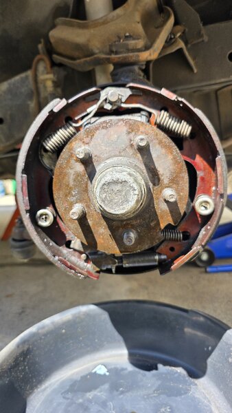

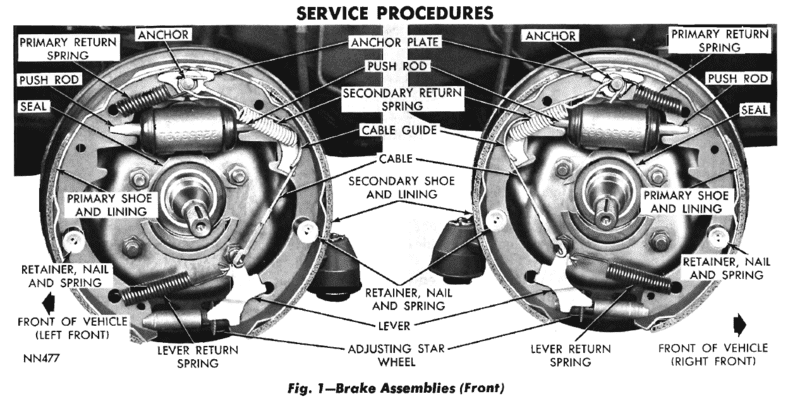

Now before i start removing things i want to know if im missing anything, I did take some pictures of what im dealing with which I'll attach here and I also compared my brakes to the picture on manual thats on mymopar.com
I did see that my wheel cylinder looks like it does not have the pins(links or push rods) like on the books picture.
if anyone can clarify if im missing them, are they pushed into the old wheel cylinder or does this year have none(which i doubt). I measured my drums shoes 10x2.5....And I currently have 14" wheels on the Dart. Also, when I removed the drum, nothing fell out so thats my other predicament about the wheel cylinder pins.

I checked all fittings and connection points...the hose is still intact with no cracks or dry rot( even the connections were dry too. I'll attach a picture of the back where the line connects.
I'll also post a picture of the cylinder itself, its not the best, but u can sorta see how the rubber is cracked/torn at the end of the cylinder.

well... you're missing the push pins. so, that's a problem.
and that means somebody put it together like that. with that level of bobo work, i'd be looking at everything with a hairy eyeball.
anyway, sounds like you're on the right path. R&R your wheel cylinders, get some pins, new shoes, check your drums, probably do wheel bearings and seals or repack them at the least. don't forget the cotter pin! double check your drop lines and master.

I don't think your brakes use the pins. Look at the picture in post #3. The brake shoe has a "tab" that goes into the end of the wheel cyl. The wheel cyl piston should have a raised section in the middle of the piston that is in contact with the tab on the shoe. The pistons in the wheel cyl that use the pin, have a small round cup in the end of the piston, and those shoes have a "notch" that fits the pin (push rod), like in the illustration in post #1
Thank you, so let's say in the future, if I don't find the same brake shoes, would I need to move to using using actual pins?
I did order some new shoes and hopefully they're alike the ones I currently have. Had to find 10x2.5 shoes they dont seem to be very common.
DOR-DOR68 are you sure your brakes are 10 inch? I looked in the 1968 service manual and it shows the 10 inch brakes with the pins, but the 9 inch brakes without the pins.

The front 10 in brakes were 2.25 wide. The 9 inch brakes are 2.5 wide
