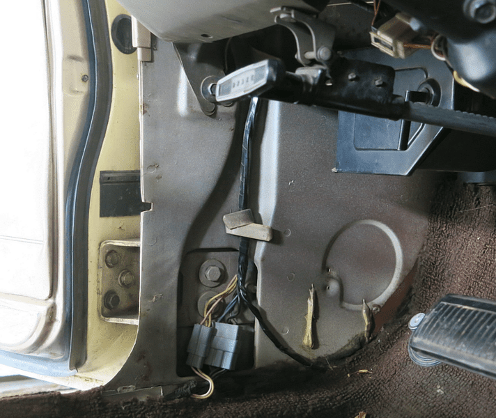

Hello all...
Just wanted to reach out and ask for some help. My Brother in law has a 71 Duster he bought to redo, and its missing the rear wiring harness. I have been trying to find out if this is a one year deal, and why they are so hard to come by. Someone said it has something to do with the rear light sockets. I have been getting some mixed answers and figure this platform has so much knowledge and experience that you all will be the best source of information.
Thank you in advance for any help and light you can shine on this for us!!

The body harness starts behind the left front kickpanel. it runs along the inside rocker to the axle hump and then along the left side of the trunk.

Well the former owner must have robbed the whole thing. Just disconnected it under the dash and took it all. And what we are running into seems to be that something with the sockets makes it a 71 only item. thanks for your help so far! if i had the sockets i think i could make one myself. have done that with other cars.

If it was cut under the dash, then you will need an instrument harness, or partial instrament harness as well. Look now, it will save on having half finished project stalled while looking for parts.
