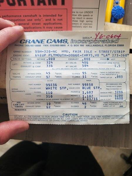

Helping me with this cam specs
That is a very old cam. More recent cams are rarely ground with 114 LSA, including Crane cams. 114 is a loser. After D. Vizard tested 19000+ cams for Crane, the cams in later Crane catalogs were ground on tighter LSAs.

114 lsa is great for the street right?
sure. why not.
wider (say 114) has a tendency to "mellow out" something that general public might consider a little rowdy. but at the expense of moving the power elsewhere (higher). generally. sometimes. maybe.
if i see something ground on a 114 i immediately think it's an ollllllldddd grind or something for forced induction.
The 104 LSA cam I mentioned above is the first cam on the page & is categorised as 'having brute low end tq' & duration @ 050 is 184/194. This tight LSA would have been unheard of [ 104 LSA ] 40 yrs ago, but testing & more knowledge has flipped some old ideas upside down....
But i understand the basics of cams...but its a smooth 114 lsa but a very big duration even at .050 , 236/244 : 114 lsa ... my mopar perf cam is : 229/233 but 108 lsa and its barely streetable in a normal summer weather , very aggressive cam, so the old Crane is smoother with a worst int/ exh duration but better lsa? ? Im confused here...
in a word, yes. the wider LSA will generally produce a more moderate idle characteristic.
it has more duration, not necessarily "worse" or what have you. how that affects idle quality is dependent on a whole host of other parameters: the other specs of the cam, compression, cubic inches, intake, exhaust and even ignition timing and the tune you've got.
Sorry for the poor quality , i bought the cam , it was cheap , i have several 318s and some 360s that i wanted to mess around with just for fun , and i dont mind having this nos cam on the shelf..even if it looks super overkill !
a 114 cam is smooth for a few reasons;
1) the late intake closing event, drops cylinder pressure, and
2) the wide Lsa has less overlap. and
3) she has a shorter power-stroke
This means less power and less torque, for a streeter. and wicked less hiway fuel-economy.
> Some of the less torque, down low, can be recovered with a Static higher compression ratio; but you can only go so far with that until you get into detonation.
> But as to powerloss at rpm, the only cure for that, is more cubes.
>As to fuel economy, most hot rodders choosing a 114 cam, are not thinking about that.
Notta chance would I install a 114 cam into a street-318, even one with pumped up compression.

So....otherwise , its almost only a forced induction camshaft? So this thing would be better in a 340 or 360? I mean it was design for a street car , why wouldnt a higher compression 318 wouldnt take it , or a smogger 360 ? It can be worst than a stock cam , if it has gears and a certain stall?
The 340 cam was not designed for performance.
It was designed for these reasons, maybe others too, IDK;
1) to meet coming stringent emission laws. and
2) to still compete with Chevys,
3) to not make enough power to annihilate those same Chevys which would have been an insurance nightmare, and
4) Chrysler still had to warranty them. That 5n50 saved my teenage azz more than once.
If the 340 cam had been designed for a 340, it would have been on a 107Lsa, had more lift, and maybe more compression.
I have installed that 340 cam into several 318s from the 9/1s to the 8/1s and the result is always anemic, until you do the stall and gears thing.
This is not the way to performance.
Stall and gears are band-aids for lack of bottom end, which, on the street, is like 95% ( I may be exaggerating but you get the point), of your driving routine, cuz after about 65mph, you are risking losing your license. With an automatic and 3.23s , 5500 will get you over 85mph in Second gear; and so, you'll only hit shift rpm ONCE on the way to 65.
In a 318,
I'll take 185+ psi with a smaller cam, over 130psi and that stinking 340 cam, any day. IIRC, I got between 2 and 4 of them on the shelf here, all were pulled out, back in the 70s. Most of us high-school boys pulled that cam out before the end of the first summer, along with the cast-iron logs, and those weakazz-springs.
That cam at 236/244/114 is even bigger than the 340 cam and still only has a modest lift.
My current cam is a 230/236/110 and the only reason it's still in there is cause I couldn't sell it, back in 2004, after I realized it wasn't the cam for me, and I had a clutch! and, a minimum 11/1 Scr engine.
Car did go 93 in the Eighth tho with that cam and 3.55s.
IDK anything about forced induction.
No, it's not "just" for forced induction. Almost without fail, a wide LSA compared to a narrow one will have a broader and flatter torque curve, instead of being more "peaky" with the power. The power normally comes on sooner and lasts longer before dropping off, but does not have as high of a peak power compared to a narrow LSA. All these "gurus" on here quoting other "gurus" act like there'll be 100HP difference and that's just as far from the truth as you can get. The fact is, a wider LSA is generally more street friendly given it's stronger vacuum signal for better driveability and operation of vacuum accessories like power brakes if you so desire. The street manners will be far superior to the same cam ground on a 108 or 106 LSA. Too many people get all hung up on boosheet magazine articles and gurus who say one is better than the other. They each have their place and the simple fact is, just tune the engine to the camshaft and it'll run fine. Remember, the factories used wide LSAs on even their performance camshafts, because those engineers knew a thing or two about good, reliable, responsive street engines. Run it and be happy and to hell with everybody else.
