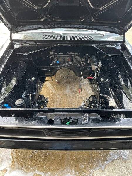

I lied. It came out tonight. This really wasn’t the plan, but while I when I was finishing up disconnecting the trans wires and driveshaft, I was like, 4 bolts and that trans is on the floor. Well, one thing led to another..

I got the headers, clutch, bellhousing, and starter on since this picture. Still lots more to go. I'm going to get a buddy to help with the trans. That thing is heavy! My worn out shoulders don't care for awkward overhead lifting anymore.
