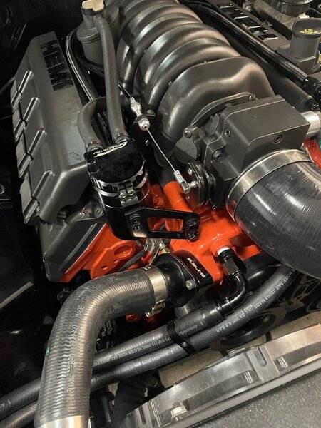

One more piece of the puzzle knocked out. Whipped up a catch can bracket last night. I wanted to hide this somewhere badly, but it also needs to be serviceable so here it is. The bracket is made from a piece of 2" flat bar whittled into something that doesn't look like flat bar.

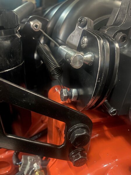

I forgot to mention I also added a secondary return spring to the throttle body. I'm not sure why I didn't think to add one earlier on, but it's on there now for safety reasons. Who knows if that Chinese knockoff throttle body will decide to quit doing spring things.
Racerjoe, can you share your idea. I need to add one to my TB as well just for safety reasons.
Of course, but I doubt your setup is anything like mine considering I made the throttle cable bracket and the bracket for the cable to connect to the throttle body.
