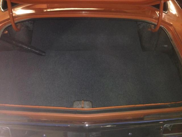

went up to Lowe's and got some of the cheapo industrial carpet and cut out a trunk mat. it was 17 bucks and it looks fine.
