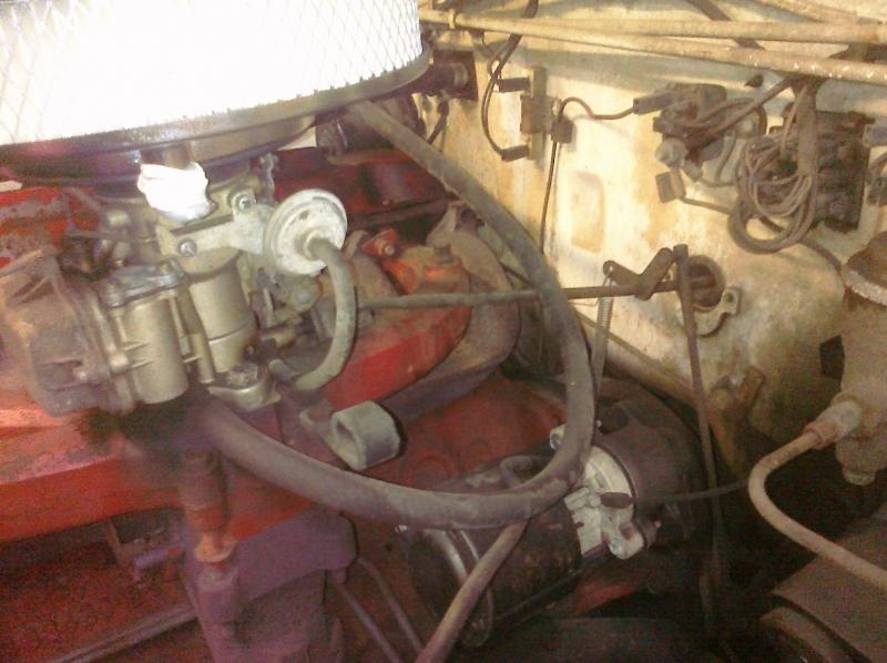

Can anyone tell me where my kickdown linkage is in these pictures? I'm having hard shifting problems with my 65 Dart with an automatic transmission so I wanted to adjust it. I've been looking at pictures of other people's carbs but nothing seems to look like mine?
You can see some of it in your 2nd photo. It's the linkage that goes from that bracket/bellcrank on the firewall down to a lever on the transmission. One of the links should be adjustable.
The adjustment is at the vertical rod that runs up and connects to the bellcrank near the firewall, on the opposite leg of the bellcrank from the throttle return spring. To adjust it, you push the top of that vertical rod rearward towards the firewall until it snaps off its ball (the ball is on the bellcrank), then unscrew the top of the rod to make the linkage longer (which makes upshifts later and harder) or screw down the top of the rod to make the linkage shorter (which makes upshifts earlier and softer).
