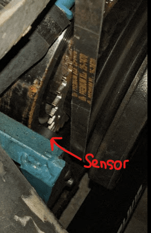

I appreciate the idea of using the pan rail bolts. It never occurred to me to fab something with steel, which I can weld.

I would like to have greater accuracy on the crank's actual position versus what the distributor is going to indicate. As Andy indicated however, on my 99% used on the street car I may just save myself the additional work of getting things out of the way to access that area of the motor/car. Things are already pretty tight down there, and then there is the trigger ring to deal with. Perhaps, it something to add after I sort and source all the other items for the conversion.

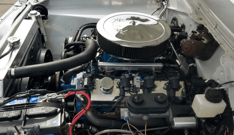

Yeah, the real question would be if you want to run a distributor with a cap or a coil near plug setup. If it's the latter the Crank trigger is probably the better move overall. The small block application, the magnum distributor is very short. With no cap and the rotor tower cut off you don't really even notice it.
I see. It's sounding like one possible approach is to add the crank trigger and the coil near plug set-up as an ignition upgrade a bit down the line. It will make it easier to get the basic EFI up and running with less down time using the dual sync with conventional spark distribution. It will take me a while to fab up those mounting components so they look and work nice and neat.
I went with the Edelbrock because i wanted spark control and EMI is an issue for a lot of people running stock ignition with the sniper tb or fitech setups.

I have zero doubts the OE ignition boxes create a fair amount of EMI. My radio used to pick it up all the time. When I went to coil near plug, it was gone forever.
The wiring for the magnetic pickup and also to run the coil aren't run in twisted pair, let alone shielded. That would probably help significantly.
