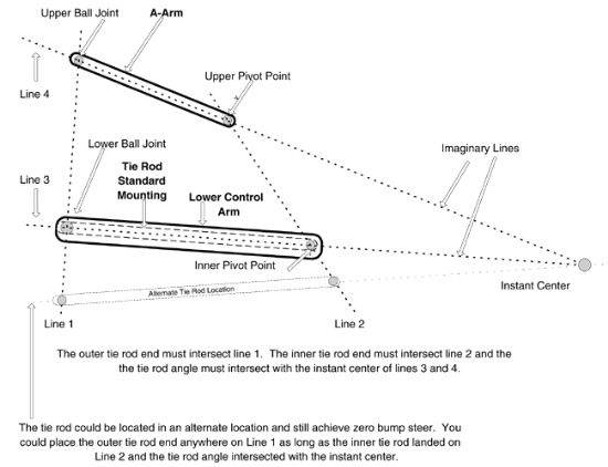

I pirated this image from another rack thread;
http://www.forabodiesonly.com/mopar/attachment.php?attachmentid=121083&stc=1&d=1263334590
To me this is a good way to understand where to start from. The problem with this diagram is it doesn't address Ackerman angle. To get that, As I see it you would just shift both inner and outer tie rods left or right of those two lines. The length of the steering arm is going to dictate to some degree how far you go also as it is affected by the line that Ackerman falls on; tie rod end, lower pivot, center of rear axle. The whole deal can be a real can of worms to get it perfect. The first measurement that should be addressed ( just chose what I thought would be close) is the length of the steering arm needed with available rack travel to give full steering radius. Using the stock dimensions will decrease steering radius significantly. I am at about four inches cent of ball joint to center of tie rod end.
One thing this diagram pointed out is the need for as high a rack mount as you can get, to try and keep from narrowing the rack.

Sorry...but you ackerman thinking is incorrect...
Please look at it this way....extend an imaginary line from the center of the rear axle housing thru the lower control arm ball joint....whether you are engineering a front or a rear steer system, the outer tie rod should fall on that line.
You are correct regarding the length of the steering arm...it drastically effects the turning radius.

Maybe I chose the wrong terms to describe what I meant. The imaginary line that runs through the center of the rear axle, then the center of the lower ball joint, then the tie rod end for proper Ackerman, doesn't change. But as the length of the steering arm changes, it affects the position of the tie rod end because on a front steer it has to be further outboard to stay on that line the longer the steering arm is. That is one of the reasons I said the length of the steering arm needs to be chosen first. To establish one of the axis the tie rod end will have to be on or close to.

I don't see a stock 73 up disc brake setup having enough room with the measurements of only 1 inch+ to allow for Ackerman . If I figured it right, there would be zero Ackerman with the tie rod right up against the rotor, or 1/8 inch away. Also, the rack would need to be very narrow at about 19 inches. The one in my racer with zero Ackerman is 18.

Getting zero bump steer means placing the outer tie rod end where ever it needs to be, and it may not wind up in perfect relation to where it needs to be for proper ackerman angle. Ackerman angle is simply the needed difference in angle between the inside tire in a turn and the outside tire in a turn. The sharper the turn combined with a shorter wheel base, the more difference there will be in angles. My race car has zero ackerman, meaning the tires stay dead parallel at all times. Makes it a real bear to push around a corner, or move it around the shop if you need to turn the front wheels. But the scrub you get when you go around a corner is liveable on a track only car, and actually is much better if the car gets sideways. The front tires don't toe out, so the front doesn't "push" and try and make the car switch ends. You wouldn't believe how fast my track car recovers from being out of shape. It snaps right back like it was on rails.
Proper Ackerman is achieved when the lower ball joint, outer tie rod end and the center of the rear axle all line up on a single line. On a front steer car, that puts the needed location out beyond the ball joint. That is why you will never see a front steer car with drum brakes. The tie rod end would be inside the brake drum! The best education on front end geometry that I can think of is in the Mopar Chassis manual. The chapter on plotting bumpsteer really explains it all very well. I hope to gert back out to the shop tomorrow and get some more things done and post some more pics. This is the front of my Racer. How many odd things do you see in this photo?
