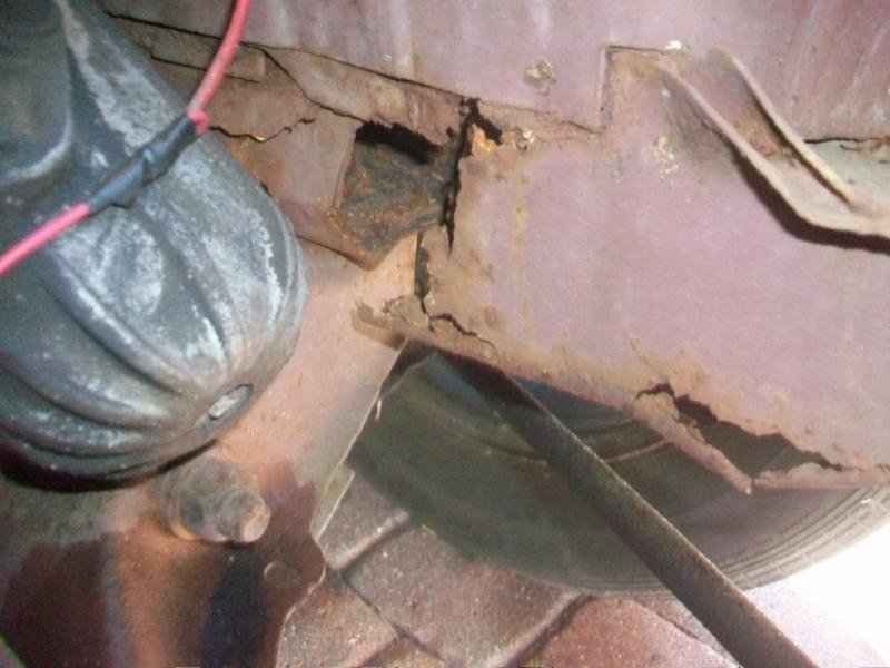

how bad is this rust?
Well I put the car on craigslist and a mechanic came to look at it for his nephew. He inspected the car and said that was the only problem with the car was the one quarter of the frame. He thinks battery acid leaked on it because the rest of the car was just cosmetic he said. I couldn't find the rails on eBay but I do know a few people with home shops I could ask to teach me. The mechanic who looked at it even said the front suspension was new expect for the upper control arms. Does this effect your previous opinions at all?
my car is the same exact way the left front frame rail is toast from the battery leaking the other 3 are clean

You answered my initial question whether the damage was isolated to a leaking battery. Looks repairable, maybe just with generic patch steel. Not a body expert, but I doubt you need super-critical frame measurements. I doubt the rest of the car moved like an accident might do to bend the frame. As long as the front wheels are pointed right and the rear axle is perpendicular to the long axis, the car should drive fine.
Before you buy a frame rail, you should probably tell us what year the car is, especially whether 1963-66, 1967-72, or 1973-77. The last 2 might be the same regarding the frame rail.
If the damage really is just at that rail because of battery acid, replacing the rail may be worthwhile. That assumes the rest of the rails are in good condition.
As far as making a generic patch, I think that ship has sailed. If you look in this picture, it appears the front of the rail is no longer lined up with the rear of the rail. Actually, in this picture it looks like the front of the rail is hardly even connected to the rear of the rail. A patch wouldn't even lay flat between the two sections.
attachment.php
I have patched frame rails before, and I don't think there's anything wrong with it if the damage is localized. But, it this case, I think the damage is too extensive to just use a patch. A patch needs good sections of rail to locate it, with your rail you wouldn't be patching, you'd be fabricating a new rail piece by piece, and that isn't a good idea.
Which means you're going to need to do some precise measuring. Leaving the inner fender in will help line things up, and so will the K member. But, you still have to make sure it all lines up. This is especially true since the damaged section includes the suspension mounts for the left front wheel. By the looks of it, I would guess that the alignment of the front left wheel has already been effected.
With the amount of damage to that frame rail, I would want to replace the whole rail. I'm not saying it CAN'T be sectioned, but, that's not what I would do. I definitely wouldn't try to patch it. I would at least want to section the half of the rail that's damaged. The section that crackedback has looks a little short for the section that's damaged in this case, although I'm sure there are plenty of cars that section would work for. Even with sectioning, you want to make sure that you cut everything back to good metal so you have something solid to weld to. Once you've done that on this frame rail, Im guessing you'll have less than half of the rail left. Plus, its actually EASIER to replace the whole rail, you don't have to worry about lining up two different sections of rail, getting the intersection of the two rails straight, getting at the entire length of the joint between the rails to weld it up, etc. When you replace the entire rail, you have more intersections to help locate it and no long welded joints, just the factory spot welds. After all, that's how the factory designed it, and how the factory put it together - there's a reason they did it that way...

yes, i did a frame rail that was as bad as yours.
my car was a true pink car, and while it would of been easier to just patch it, i listened to alot of members on here, and they were right that do it once and never have to worry about it ever again!.
it took alot of precise work, with measurements and all, but once done, you couuld not even tell it was done!
i also have done tons of body work in the past, but once i started on it, i thought i was in over my head, till i talked to a few that have done it before. if you get frustrated with the gazillion spot welds, then it is time to walk away and take a break from it. it was not hard work at all. just took time. and the best part is that it is all pretty much self-explanitorty!. that frame rail is not eaten fron just acid!. i thought the same with mine. once i took it out, i found out it was rotted from the inside out.
