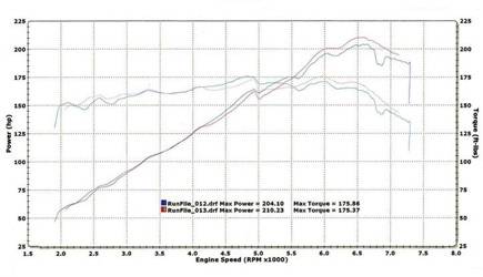

It's simple Rob. A dyno DOES NOT measure HP. It measures torque. HP is a mathematical calculation from torque, look at the formula. "There is no such thing" as HP in effect. It is in fact a product of mathematics
Horsepower = torque X rpm / 5252
EDIT read your link LOL, explains it better.............

Of course a dyno measures horsepower. It measures torque and rpm at every point in time and reads out horsepower and torque.
Doesn't an ammeter measure amps? It actually measures a voltage drop across a resistance.
HP is not just a function of torque . It a a function of torque and speed (rpm).
A steam engine can produce full torque immediately (0 rpm). 0 hp.
There is nothing magical about 5252, its just a number that results because of the units of measurement that are used. There is no way to calculate hp directly from torque.
You are playing with words. If you are going to say that a dyno measures torque and rpm, the answer is THE DYNO CALCULATES HP from those two measurements. Torque can be measured DIRECTLY. It's called foot and pounds, IE length of the arm or linear measurement of a weight over distance
The point is that there is no basic singular device which can measure HP as such.
and yeh. Some ammeters measure amperage directly. Not all ammeters have a shunt and a meter. A moving vane meter pretty much measures the strength of a magnetic field through the conductor in the meter. A hot wire meter is another The wire changes with heat cause by current. A basic d'Arsonval meter........the basic meter, not with added external multipliers or shunts........also measures current due directly to magnetic action. It could be argued that a gigantic d'Arsonval movement could be constructed that would measure substantial current directly with no shunt.
The point I was attempting to make, earlier, is that in order to find max performance shift points, you need a HP, or a torque, or an acelleration curve for at least one gear throughout the extended RPM range of the engine. With that done, you can plug the addtional transmission ratios in and find where the progressive gears cross in the curve.
There's no reason you could not fabricate a load cell into your motor mounts and use that
