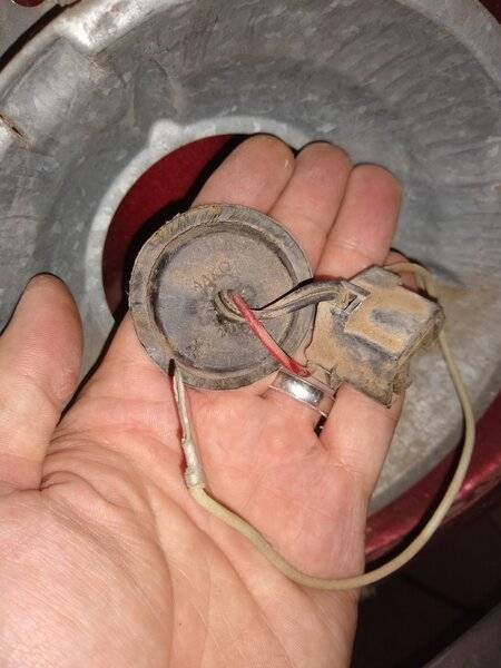

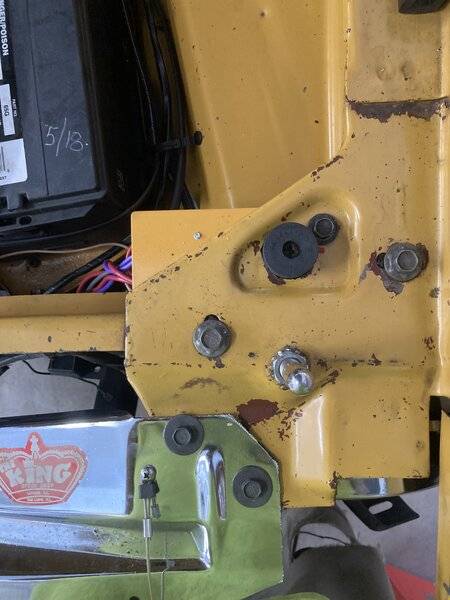

Thanks for the topic. I just got these and I was installing them and there was no way I was going to get the light connectors through the bucket grommets. I also just found out I don't have fender plugs. lol

If you need to you can split that grommet. What I would do is remove the terminals from the relay block and feed them through the holes in those grommets.
Not sure how Rusty addressed it on his install.
A good hardware store might have the correct size plug if you are missing them. Don't want wiring chaffing in metal edges.
@Witchboard
I took a razor blade and put a split in mine from the center out. Doesn't hurt a thing and when you install it, it pushes the grommet right back together.
