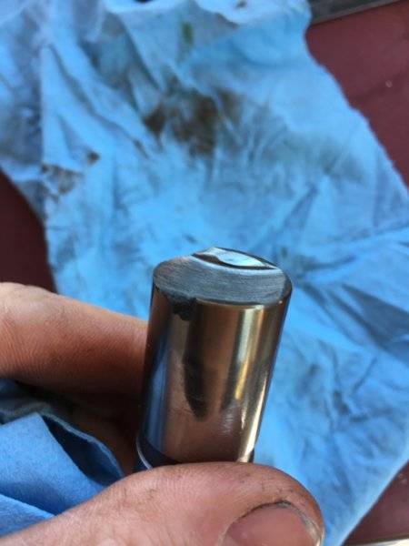

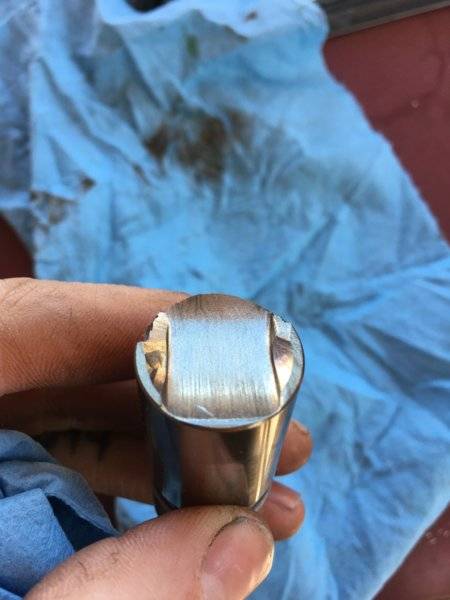

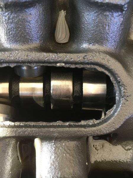

Supposedly an Erson cam and lifters installed by previous owner, no idea on how many miles on them prior or what year manufactured, but after 3 years and maybe 10,000 miles on sons 360 (78 Magnum) it developed the dreaded clack. Assumed a collapsed lifter or bad rocker arm. During manifold swap, lifter and rocker arm inspection we found one concave lifter face and rounded cam lobe. All others literally look like new.

And BTW, the lifter issues we've been seeing having been in noisy, tapping, collapsing lifters. Have not had one chew itself or the lobe to bits.
