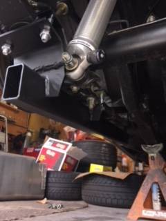

I can't see the entire traction(or assassin) bar you have installed, but if the style like I have are not adjusted right, they won't work. Hence the bad rep. I haven't seen one set that bolt's on correctly to a Mopar without cutting and welding.
i had to cut my frame rail to fit the adjusting bolt for my front hangers. and dented the frame rail behind that to clear my asassin bars as well.
I uploaded the wrong pic.
