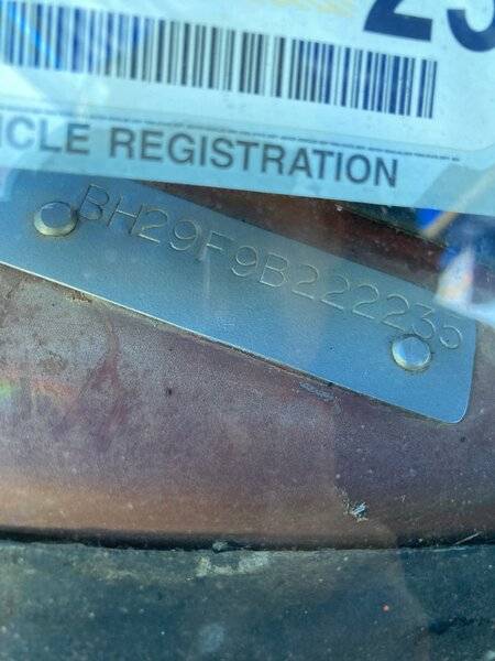

Incorrect dash vin tag

I had a Dart that the VIN did not match the core support or fender tag but the VIN matched the title. Got the out of state inspection and Ohio said "no problem". When I sold it, it went to Iowa. I always thought someone changed the dash. I bought it out of KY. I agree, you VIN tag is completely wrong.
The dash has been changed, end of story. The REASON that it got changed, is that the "rest of the car" had no legit title, could have been stolen, lost, and no one was willing to do the right thing. If you screw with this, you could end up with NO car, or a parts car that can not be titled.
First thing is to contact the seller, and make it ******* CLEAR that he needs to step up
If you can't fix it I mean ABSOLUTELY can't, you might be better off to "leave it be."

Unless you have a motor vehicle registration from the previous legal owner, listing the correct vin for that particular car, the vehicle is not yours. As you said, the previous owner never registered the car so if he doesn't have a bill of sale from the person he bought it from, it wasn't his either. Before you do anything, establish if the guy you bought the car from actually owned it. If he didn't register it, he should still have a bill of sale or a document signing over ownership. You need to establish who sold the car to the guy you bought it from. Then, that person may be able to solve the vin issue.
By the way, if you traded one car for another, its still a legal transaction and, still needs a bill of sale to transfer ownership.
Also, if the last state where the vehicle was sold assigned a new vin number, the registration should state that clearly.
I 'm going with Alaskan_TA on this one.. this whole scenario looks and feels totally fu#ked up and is going to result in a whole lot of anguish the minute you try to register that car. At first glance it looks totally illegal!!
Every government issued tag I've ever seen looks nothing like an OEM tag, NOTHING LIKE IT. I smell something really rotten here, I would get whatever you traded back and void this deal ASAP! The old saying "possession is 9/10s of the law" doesn't mean ignorance is an excuse.

The broadcast sheet matches the radiator support
The broadcast sheet should have the full vin on it.

Yes the VIN tag looks way off from original, but matches the ownership. Is there any chance that the car was simply re-vinned through proper govt channels similar to the way that a car bought from a scrap yard, abandoned, dead original owner...The list goes on? My guess that if it was a swapped dash, it would have some sort of OEM vin tag and proper rivets from the doner car. Thinking out loud......OP definitely has to run, or start jumping through hoops. But I certainly wouldn't try to slide this by anyone.
If this was a state re vin, it would state that on the new title.
No that is not what happened. What happened is, no one had a legit title for the original car. They either swapped the dash frame, or they swapped the VIN tag with a car that HAD a title. What he has is a title for a dash VIN tag and nothing else, fully, legally, speaking. Wherever the rest of that car is, "he owns it"
Could be that someone had a rusted car and found a clean roller then swapped everything over . Most people dont know the body is stamped .
The weird dash plate dosnt make sense though
LOTS of questions. Where did you get the broadcast sheet from? What did the seller/trader say about the missing fender tag? Did he explain anything about the clearly NON OEM made-up VIN dash plate?
The broadcast sheet came out of the car it matches the radiator support and all other tags. It doesn’t match the vin tag. Again this car is already registered and insured in my name here in NYS.
There was a bill of sale and a title from WV when I registered the car.
Hey 67Dart273,
I would tend to agree with you except for one glaring issue... The VIN tag is fake!
Check the image below. The letters and numbers in the vin are raised.
In the one the op posted the numbers and letters are depressed.
Not a factory vin tag. So where did it come from? If government issued , it would say so on the new registration paperwork.
What he has is a car with a fake tag using vin information from another car that was wrecked/crushed or possibly stolen.
