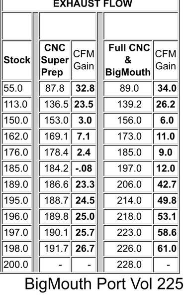

Here’s Hugh’s flow numbers. Are they even still available and how much did they cost.
These are the numbers I found and what they were sold under as being. IntKe listed first, exhaust second.

There pretty conservative on the power possibilities of the stock head of 417 hp compared to their CNC super prep with gains of 20+ cfms on low lifts for an estimated 540 hp.
Layman’s rule? CFM X’s 2 = potential power.
258 rounded up .1 cfm.
258 X’s 2 = 516 HP. There est. is 540, 24 hp more, that’s doable.
Conservative? I guess that depends on how far you want to push it. The cfm X’s 2 is good for guys in the street looking for a good & respectable outcome or a casual but quick bracket racers.

My point was they only rated the stock Edelbrock head for 417 hp, (1.61 hp per cfm)

I find most builds we see fall short of the 2hp per cfm, 1.7-1.9 hp per cfm for 230-250 ish cammed engines.
I think you misunderstand. If “They” is Edelbrock. The head is not rated for that level but the power package is.
