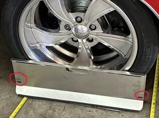

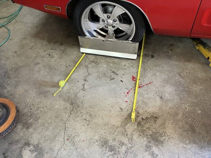

Toe is easy to check if you have the tools.
I bought toe plates to do the job. They were under $40.
They go like this:
You hook the tape measure in these slots.
Then you compare the number on the front tape to the number on the rear tape. They should be 1/8" apart with the bigger number at the rear tape.
