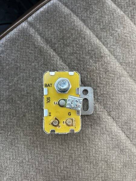

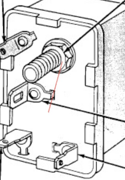

Just for clarity, let's repeat, STARTER RELAY. You have THREE terminals if a stick shift, FOUR terminals if an automatic. The smaller ones are "push on" or flag terminals. Those are small, and booted/ insulated. Only the large stud, and the one beside it, the big square screw terminal, are bare. Those two are what you jump.
In this photo, "B" (battery) and "S" (solenoid)

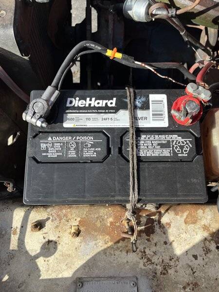

Battery is at 12.3v. Shorts at starter. Battery connectors good. Ground wire from battery to block is good. Starter cables good. My relay only has 2 posts on it.
When I short on the other one I have between bat and sol, nothing happens but a spark. As in I replaced the old relay with this one you pictured, hooked up the battery, ignition, and solenoid, and got a spark when I shorted the solenoid and batt terminal. Car ran and drove today with no problems.

No idea what this means, can you post a photo?
There is only so much we can do by guess and gosh by remote control. Do you have wiring diagrams/ service manual? It might be time to find the local equivalent to "one of us" who can take a look at the thing.
Has the wiring been hacked up or what?
The one you sent earlier, the one with 4 terminals (BAT, IGN, SOL,GRD). I switched it back to the original two tang one with the screw connector and the tang. (FLN, IGN) and it still works. Definitely not the relay then. Problem lies elsewhere. Wiring has definitely been fucked with, Many previous owners and 60 something years on this earth haven’t been kind to it. Pics might be low resolution so wiring diagrams are available here - Wiring – MyMopar
Still no idea what you have in front of you.
We don't need to see a diagram. You need to show us what you are working with.
Without that, best we can do here is explain how it is supposed to work.
First. Before any testing, slow charge the battery with a charger.
12.3 Volts with nothing on is on the low side.
With the starter engaged it should be above 9.5 Volts. This is a load test and reveals the charge state and condition better than measuring with no load.
Starting sequence illustrated here.
How the starter relay works.
Battery (after two 30 min drive and sitting for a half hour) measured 12.9v. On startup fell to 12.6v before stabilizing again at 12.5 on idle. Attached pics show battery connections, current starter relay, old one, and the other new one that also worked (yellow). Need a pic of the ignition? Car has an aftermarket temp gauge that comes on with either accessory position, a speedometer that plugs into the cigarette lighter and an aftermarket tach.
I'm not seeing a current starter relay....only the new one in the last photo. The other photos show the voltage regulator and the battery. 12.5 volts at idle is low. Does it go up if you raise the RPM? How old is that battery? Have you done a load test on it?
