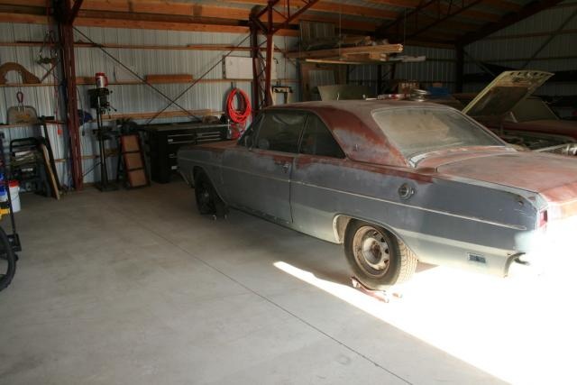

Just another Dart....
I know exactly what you're talking about. I think its the worst water trap on these cars. What I plan to do is slice it just above the lower horizontal attachment, bend it up so it can be inspected and sandblasted. Replace metal if necessary. Then weld shut again but leaving some sizeable drain holes. POR 15 with a swab. Polyurethane caulk beween drain holes so any moisture gets funnelled down the holes. Maybe a screwed on plastic shield to direct water off the rear tires away from the holes.

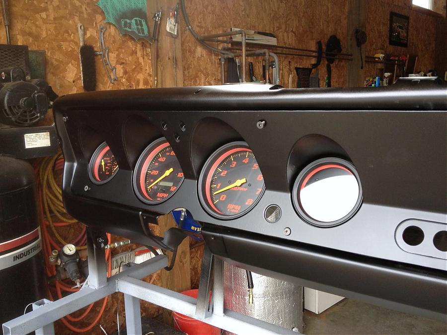

Finally got the instrument panel ordered from Peak Dashes. Mark is not the best communicator on the planet, he is even worse than I am so if anyone is going to deal with him be patient.
Have to order my gauges from Speed Hut some year.....
Not to get to personnal..... but whats you hole size ? looks like 5" speed/tach ? ...and 2 3/8" for the others. Autometer has a real cool custom gauge builder unless your sold on speedhut, I looked at them all and went with custom made Autometer.

Personal?? Nah......The bigger holes are 4 1/2", the smaller are 2 5/8". After the nightmares I have had with the Autometer Speedo on my chopper I decided to use a different brand. In Autometer's defense, when the speedo was under warranty they took care of it...by replacing one defective gauge with another one. The one I have now is doing the same thing the previous 3 did. I really wanted SW gauges but last I looked they did not have a GPS speedo which I really want to use.
