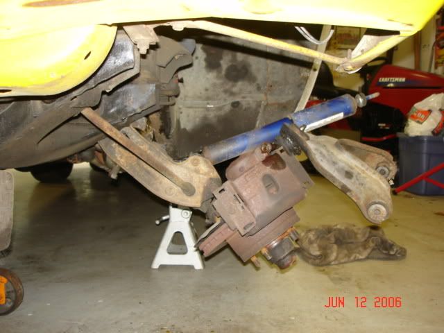

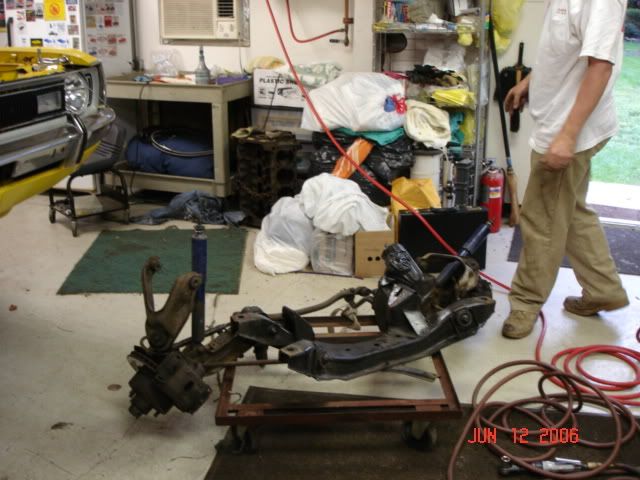

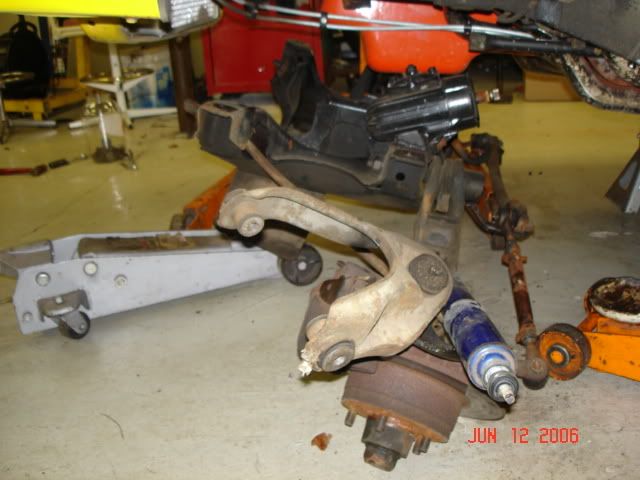

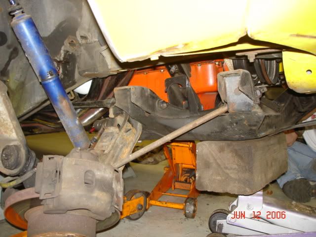

its pretty easy and straight forward.. you just have to really look at it before you do it and you will see how it comes out.
i left my motor in when i did it. i also pulled the column out since i had to do that anyway.
when everything was unbolted. i lifted the motor an inch or two, lowered the k-frame an inch or so and banged the k-frame forward to get the lower arms off the torsion bars...
