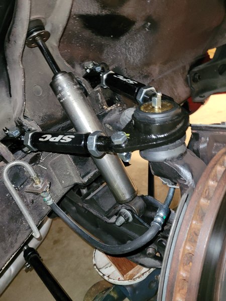

Adjustable upper control arm opinions.
I've posted this other places but should have added it here too. These adjustable UCA's took the avatar from being able to make a full pass at the track maybe about 60% of the time to a car that goes dead straight eery time. They solved a serious lack of positive caster problem for me.
Little wheelies and almost 120 mph passes - I don't have to think or worry about these parts that have been on the car for over 2-1/2 years. They've seen more street driving too than you'd expect from a car like this (another 50 mile round trip to a cruise coming up this weekend!) I have not had any of the jam nuts come loose and the parts look like the day I put them on. Would I do them again from Peter? 100% ABSOLUTELY!!

Thank you for letting me know how they're working for you. I think the lack of caster on wide tires is why my car feels as disconnected as it does.

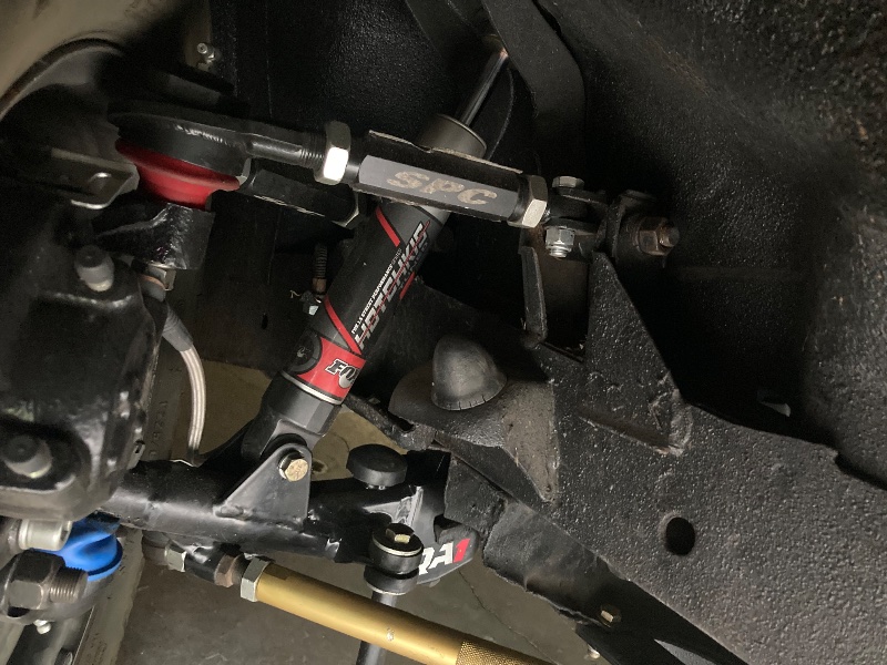

This, 1.03” bars, 225/60-15, Hellwig sway bar, Borgeson , and QA1 LCA’s. Daily driver and a pleasure to handle.
The next Duster will be the same recipe except bigger t-bars and double adjustable Fox’s.
I've seen those lower control arms before. They don't seem nearly as robust as the factory arms.

Good looking set up. And to be honest, the 1.08" torsion bars are on harsh side going from whatever the stock V8 bars were. I might go down a size or two in diameter and sell what I have.
Quite the opposite. I've had the QA1 LCA's on my Duster the same amount of time as the SPC uppers. Their tubular design makes them substantially stronger than the factory ones.
Mopar Action did a comparison on them, the factory LCA's and the Firm Feel modified 73/74 B-body LCA's in an article from April 2011. At the time the tubular LCA's were being made by CAP, and even those managed to be substantially stronger than a factory set of LCA's. Must have had a set from CAP with good welds. Anyway, QA1 bought out CAP and improved on the design further, as well as of course improving the manufacturing process that CAP clearly had issues with. Anyway, the relevant excerpt from the 4/11 Mopar Action article-

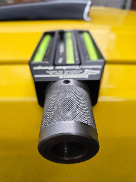

The reason I don't have good alignment numbers yet is that I bought a Longacre alignment gauge cheap, and don't feel like paying $85 for the adapter that threads onto the end of the spindle. I'm in the process of making the part. Once I get it done, and some time to mess with it, I'll get actual numbers of where it's at now.

Nice! An adapter like that would definitely make using a magnetic gauge a bunch easier.

The adapter turned out pretty good, pun intended.
Now I can thread it onto the spindle.
