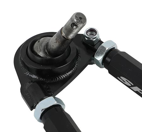

The "sort of" comment has two parts. First, while I can't say for certain, I think the inner metal sleeve and washers for the inner mounts are different between the above and Peter's (@BergmanAutoCraft). Based on the pictures of the above, they don't look like what I bought. Second, I think SPC discontinued the style of the UBJ mount as shown on the right (PS) arm.
The UBJ on the right arm above is tipped, but in the front/back direction in relation to the car.
The left (DS) is tipped in the in/out direction in relation to the car.
It appears SPC has discontinued the part with the UBJ angled back (gold part above) and only lists the one with the UBJ angle in/out (black part above). Not sure it really matters, but it is a difference. I talked to a guy from SPC at SEMA and while he vaguely remembers a change, he couldn't tell me why or even what for certain.
No idea if the remaining 94460 arm from Summit would have the UBJ angled front to back like it is shown in the pictures on Summit's website, but my guess is that the 94461 arm will have the new style since it will ship direct from SPC.
So, while you can buy all the parts or a complete control arm, I think the inner mounts will force some rework that Peter's did not. So yes, you can get there, but not as smoothly as buying them from BAC.

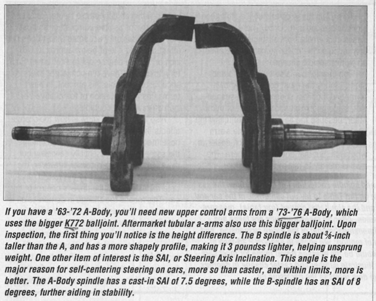

It typically improves camber gain and roll center geometry in A-body handling applications.
I think Peter Bergman looked into it and came to the conclusion that a 1/2" taller ball joint would improve the roll center further on his car which I believe also runs FMJ spindles.

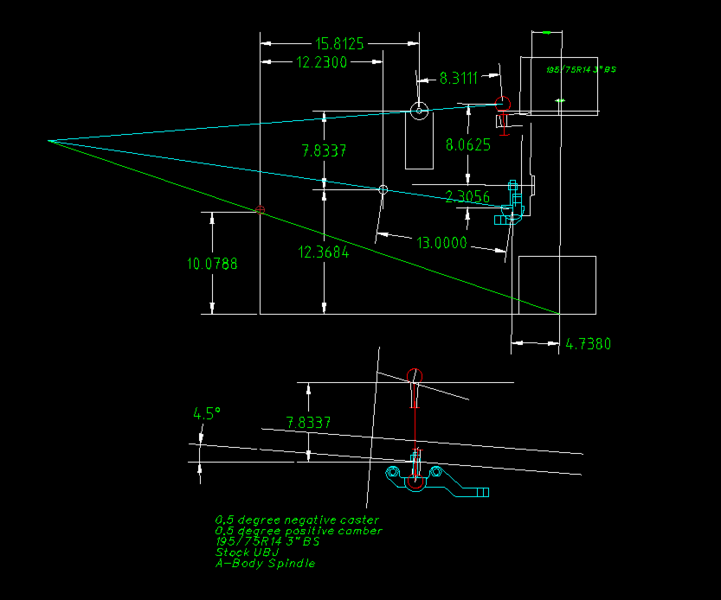

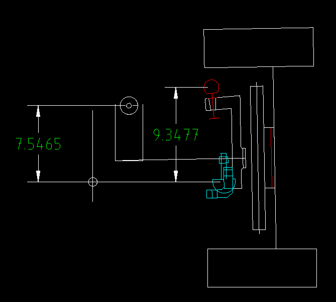

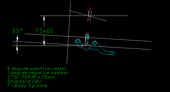

I'm curious though, since you measured everything, what the difference is between the center to center on the UCA and LCA pivots vs the centers of the upper and lower ball joints with the A body or FMJ body spindles. Does a level LCA (pivot to center of ball joint) actually put the upper ball joint above the UCA pivots?
A-Body:
F-Body:
Note that the inside upper pivot height is dependent on caster and such. Because it is a sloped mount, the effective height is where the UBJ is at 90 degrees to the two mounts. Here is a side view of the F-Body spindle:
So less caster would move the UBJ forward and effectively raise inner upper mount height.

Here are some examples.
A stock A-Body ride height has a static RC of 6.3".
1750903375409-png.1716422837
With the F-Body spindle and 1" longer UBJ, the RC is over 10".
This is using the stock alignment specs, don't miss that.
So, in my inexperienced opinion, regardless of ride height, an F-Body Spindle and 1" longer UBJ would be a detriment in all cases (in theory) because the RC would be higher and jacking forces greater.

FMJ spindle geometry has been looked at before, and it improves camber gain. All suspension geometry is a trade off. Ehrenberg initially made similar statements about the FMJ spindles having negative effects, he was thoroughly debunked by Bill Reilly (Reilly Motorsports) in this article with all the geometry numbers to prove it.
Swapping A & B Body Disc-Brake Spindles - Debated Usage
It should also be noted that the spindle height is not the only difference between the A body spindles and the FMJ (and B body) spindles. This footnote has been lost out of the online article I linked above after all the magazine buy outs and website format changes, but the later spindles also have more build in SAI, and are 3 lbs lighter. The increased SAI also tends to make cars MORE stable, so, the later spindles should cause LESS wandering in a like to like comparison with the earlier ones.

To be clear though, the slope of the UCA needs to be up to the UBJ when the LCA is flat. If the LCA is not flat but instead slopes down to the LBJ, I wouldn't want the UCA sloping up to the UBJ as the RC would actually climb then.
All good points, and I appreciate the time you've put into plotting all of this out.
That being said, it IS ride height and alignment settings dependent. I know Peter Bergman worked out the RC for his car, and initially found that he was getting a "below ground" roll center. It's why he briefly went to drop spindles on his car before finding the negative effects of those (mostly bump steer) were worse than the RC issue. I believe he went to the 1/2" taller ball joints after that.
The bottom line is, all suspension geometry is a trade off. Improving one thing usually happens at the detriment of another, and car set up, use, and driver preferences end up having a large impact on the "best" geometry.
