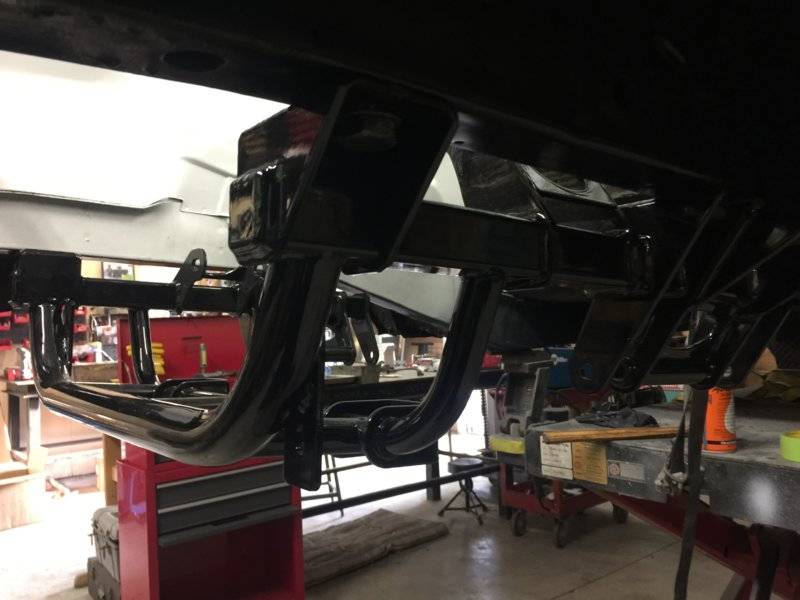

I just cleaned them up with a wire brush and hit em with some compressed air... torqued them to 150 FP
