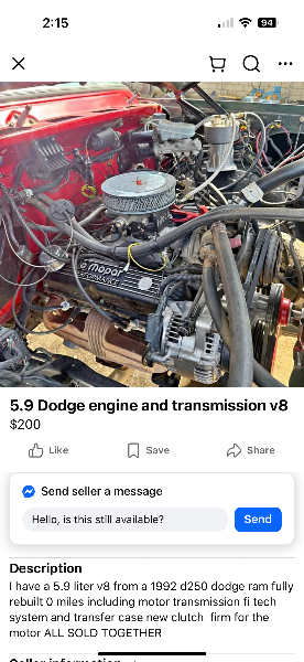

back then? it was 4 years ago. and I got a 360 with a transmission for $250 this year as well. the trans dapt mounts are still $90.00.
lol.. almost 5 years ago is huge. **** has sky-rocked in those years. unless i saw a $250 motor and trans running and operating in person i sure as hell wouldn't just be sticking it in a car that i want to drive.

Yea right, fully rebuilt 0 miles motor, trans with new clutch for $200.:lol:

You never know till you ask. For $200 it would be a trip worth taking if you were in the market. Hell that thing is 5 miles from me, I might go check it out just because.
