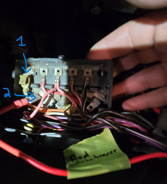

@67Dart273 So heres an update Im hoping you can help me with, you seem very knowledgeable in this area.
I have done the entire MAD wiring upgrade, just as they instructed, both the direct to battery from alternator fix, and the amp gauge bypass. The only ways I strayed from their instructions was I avoided splicing to lengthen wires by replacing the old wires(black and red main wires) with new 10g single piece wiring, much cleaner and efficient of course, and secondly by avoiding another "welded splice" by utilizing a Wago wire connector rated for 10-20 gauge wire to connect all those wires. Google these if you havent heard of them, they are amazing, Ive used the 12-24g version many times in household wiring with great success.
So everything seems to be working fine, car starts and runs fine, my volt gauge says Im charging again, and everything works EXCEPT for the headlights. At the fuse block, the #1 terminal has no power to it at all with key on, and Im sure it is the cause of my problem; when I was putting it all back together, I mistakenly put the red with tracer wire from the "splice" to the #1 and I had headlights, but other problems such as dash lights staying on, no buzzer when the key is in the ignition, and the dome light not coming on at all. I figured out my mistake and put it on terminal #2 as shown in the pic and everything now works but the headlights.
So obviously my question is, did I disconnect something from the #1 that I did not reconnect? I cant see any extra wire laying around, but in all the process of doing this, something may have gotten taken off and not accounted for. Or perhaps its something else that I havent considered? Did I fry the headlight switch perhaps??
Also, these is power at the B1 and B2 connections on the headlight connector.
I have also replaced the cheap chinese VR with a factory Mopar unit.
I know this has to be something fairly straight forward that Im missing, but electrical is not my specialty.
Im soooo close to having this fixed, any help and suggestions are greatly appreciated.

The headlight switch headlights only power (you probably realize) originally got UNFUSED power from the welded splice. This was likely done to INSURE that you would never lose headlights unless the main fuse link blew. It is important to carefully pick your headlight power source so you aren't suddenly "in the dark."
But if both B1 and B2 are getting power WITH THE SWITCH ON (under load) then I would say you are in the wrong area.
Next thing to do is see if the HL switch is sending power down to the dimmer
B1 is headlights only, B2 is tail/ park and instrument lamps

I never checked for power with the switch on, only key on, the switch is still in the cluster, Ill take it out and hook it up to check.
Could a bad dimmer switch be the culprit? I think I saw a post somewhere on this site where a member stated that a bad switch can cause no lights at all. I will check for power down at the dimmer when I hook up the switch
thank you again for all your help and direction :)
The reason I always (if possible) suggest checking power with the key on, is in case of a bad switch or in the case of a headlight switch, the built in breaker
It is very possible you could check power at the B1 terminal and it's OK (you think) but then with the switch on, no lights!! Could be the switch is bad, or could be a bad connection in the wiring BEFORE the switch is droppin power off when you try to load it.
@67Dart273 FIXED!! Turns out the headlight problem was a bend spade terminal on the switch, I must have put the connector on cockeyed the first time it went back together and it bent the B1 terminal down, once straightened, everything works as it should :)
Thanks for all your help, it was much appreciated, beers would be in order if you were closer, cheers!!
