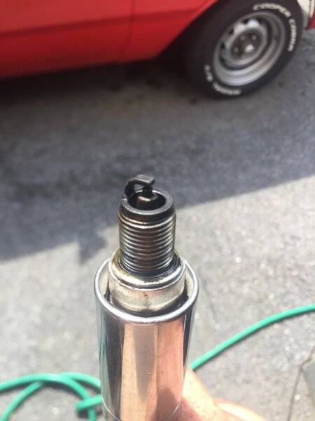

What do the spark plugs look like?
Post some up close pic's of the plugs showing the ground strap, should give you a good idea of whats going on.

Picture of plug 1 coming up
I’ve since leaned the carb out 8% in both cruise and power mode per the edelbrock tuning chart, but haven’t/can’t get it to run enough to get a new read on them
That looks to me like an unhealthy cylinder-compression wise. So yeah it can't burn the fuel=rich. J.Rob
Certainly has some oil on it. I’m working on a TR tune and when o got here the plugs look like that. After pulling some fuel out of it, the oil cleaned up. Maybe the OP will get lucky.

You gotta excuse my ignorance and elementary questions as I’m pretty new to this, but what do you mean by back side of the ground strap? I’ll glady take the picture, just don’t know what your talking about
It shouldn't have a hard time cranking with 10 deg. Have you verified your balancer actually corresponds to TDC on #1? Not uncommon for them to slip, and then you're chasing your tail.
The ground strap is the L shaped piece of metal that protrudes from the plug threads to the gap at the tip of the electrode in the center of the plug.
Here this will help
Spark plug reading can be complex and sometimes frustrating task this page will help make it easier and the results rewarding
Read thru the above link
You can learn alot about the fuel and timing reading the plugs correctly.
Report back when you have read the link you will have a good understanding about spark plugs.
Dont be afraid to read it more than once its good info and is the key to tuning any engine.

Start with a fresh set of plugs, if all the plugs look like the one you posted they are junk.
