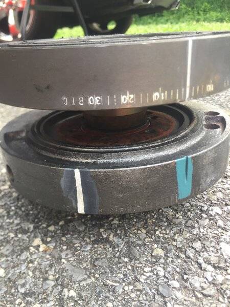

Alright so I’ve got the pressure regulated down to 4 psi. I’ve got new plugs, wires, and cap in there now. I ordered a new harmonic balancer in for it and got to taking the old one off today. I think I found a huge problem. Check out how much that balancer slipped... no wonder I couldn’t get the car to run right no matter how much carb tuning I did.
New balancer is on top, old balancer is on bottom, the key holes are lined up.

Probably didn't have piston stop at the time. Does the crank key point right up #1 cylinder? Found that to be true. I paint a white stripe from ring down past the rubber strip to hub to keep eye on slipping. Found one slipping and have not seen it happen since but I now run a silicon damper. Im actually making a yoke for my slants balancer out of .080 AL that will bolt to the hub and have 3 fingers that will extend past the bond and bend 90 degrees into 3 of the 36 notches I machined in the ring so it will have no chance of moving farther than the slop in the hole as I'm running 36-1 EDIS timing off the ring. I dont know how much those rings are designed to 'move' but I cant afford it to as planned. The Hall sensor wont pick up the AL tabs.

Bingo
Which timing mark were you using? The white or the green?
Just started reading this.... the balancer slipping would be the right suggestion and you found it. Explains why the chop came back.... your 10 BTDC is actually, what.... 50 BTDC? 30 ATDC? And it explains the hard cranking.

Oh sorry, I should have said that. I was using the white paint mark on the original. I bought the car last fall after this guy used it at the track and occasional rides, so I don’t personally know EXACTLY how the motors built, all I can do is go off what he told me. So it’s a 360 bored .30 over, edelbrock 1405 carb with manual choke, edelbrock performer intake, it’s got the police interceptor heads that have “serious work done to them” (his words not mine), an unknown lunati cam that he said was a big cam, Keith black pistons, and I’m not sure more then that. I just installed Mopars electronic ignition kit to convert it over from points (odd thing was he was running points, but had the harness for electronic so I’m not sure why he didn’t run electronic)

OK on the white mark. Yes that would force you advance the timing 35 degrees to get it to line up at the same point as the new damper. Looks like the green mark on the old damper was correct. No wonder it was hard to crank when hot and idling messed up... you had 45 degrees initial timing in it! Probably it was detonating too when it was missing and backfiring.
Fair warning: You won't get the torque you had with the base timing so far advanced.

Yeah oh yeah it makes sense why it was very hard to start and ran like crap. I’m okay with not as much torque, it was acting like a dog yanking on a chain and as soon as I hit the gas it tore off, but was not street able. So if through all these fixes I get a car that starts, runs and drives well I’m good with it! When I get a chance I’ll try to get a compression reading on it and then also grab those casting numbers off the heads for reference
