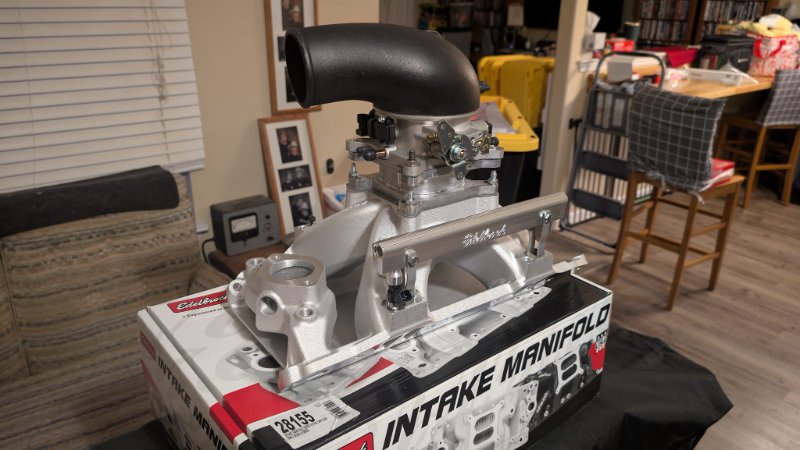

Edelbrock supervictor EFI Part#28155
Edelbrock 4150 throttlebody Part#4150
Holley 120lb/hr Injectors part#522-122x Also purchased some injector extension cups.

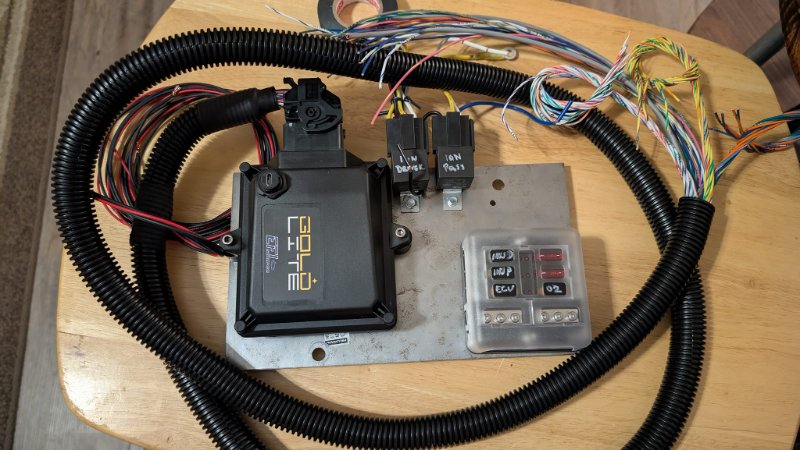

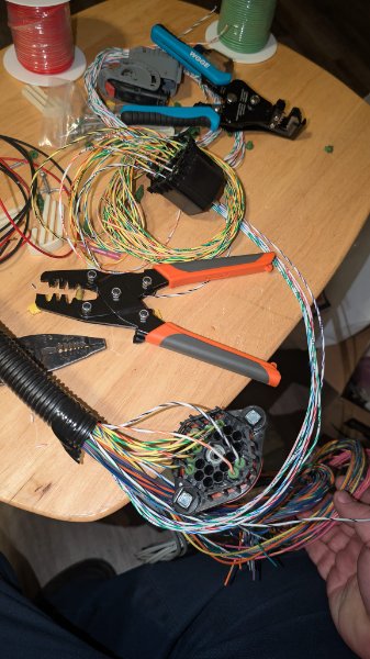

EFi Source Gold lite box w/ supplied harness
I had to purchase the injector plugs and everything else separately.
I used a cheap fuse block for the injector setup.

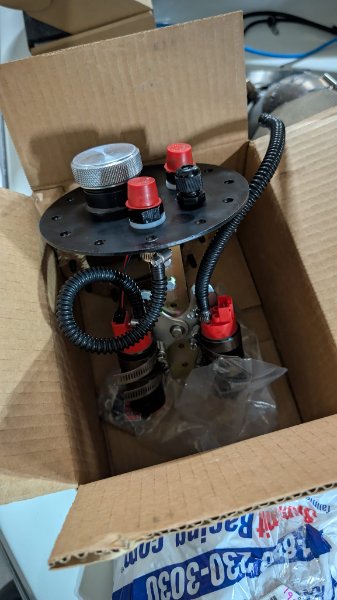

I changed my fuel cell to use internal pumps, twin 340lph fuel pumps with -8 feed and -8 return. With a full return style setup. I already had a fuel pump relay in the back of the car in the trunk, so I just ran the trigger wire from the ECU to the existing relay, which worked out well.

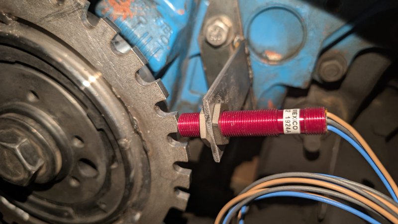

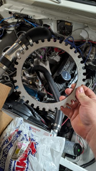

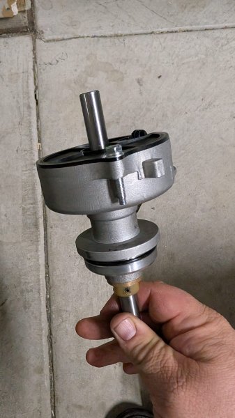

Ignition system I decided to do coil near plug. So I needed a cam sensor, I ended up using a magnum v8 distributor but without the cap. I simply cut the shaft where it protruded above the cam sensor, eventually I taped it over. Some day I'll make a cap for it. But the cam sensor is a simple half moon style, This also means I needed to use a crank trigger of some kind. So I had ordered a 36-1 wheel from a UK company that was about the right size to weld to the front of my Harmonic Balancer, just happened to work out just right. I also built a crank sensor mount with some scrap metal, it's ugly but works. I may take it apart and weld in a brace if I run into any wierd issues, but for now it's working.

With the crank sensor and cam sensor figured out, I used GM LS D585 coils, made my own plug wires to fit. Not gonna lie it took a bit for me to get everything figured out in Tunerstudio, but once I had everything set right, it's pretty good.

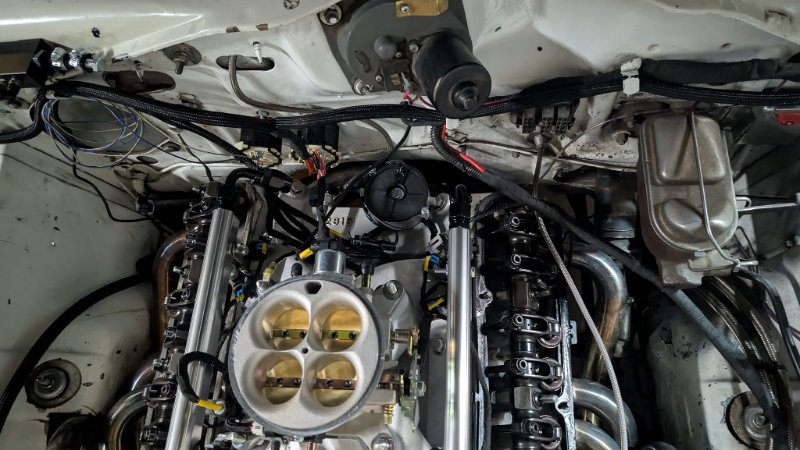

Looks great. You are tenacious! You can always just buy this for your distributor cap. Holley makes one too, but it would be the only thing Holley on your set-up. Nice to see people doing this stuff.
[/URL]
dude, thats awesome. I didn't know they even made that. But not sure it would bolt on to a factory magnum distributor. I guess I could always drive to summit and see.
