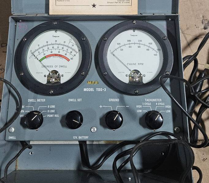

Fairly new guy here, C.Galloway, trying to get his slant 71 A body fired after a long sleep. Screwed up last night, fell asleep in my chair and woke up a t ONE AM new time, got up at 6, so not much sleep, LOL. Went out to his place about 9:30 and got home about 2:30. Compression was low, either the long nap dried things out, or maybe got washed out. Squirted some oil in the holes, he had new plugs, and there were recent cap/ wires. Points were fried. Replaced points/ condenser and THAT went WAY better than I could have hoped. "Guessed" at the points gap and plugged 'er into the latest military supaw doopaw dwell tach and the dwell was RIGHT ON

The meter. Bought this, made by Simpson for the military, and it will also handle the outboards. 2/4 stroke, and in reality will do anything from 1 cylinder to ??? The one scale is in percentage instead of degrees. This means if you have something that's oddball, you can "figure" the percentage and use that scale.

Cool stuff, Del! I like that meter, too!
That is truly a HEAVY duty piece!!! I bought it mostly for the outboards. The tach has two ranges, up to 5K which is not high enough for some of the outboards. But the circuit is fairly simple and I believe I an add a switch to make it 5K / 10K.
