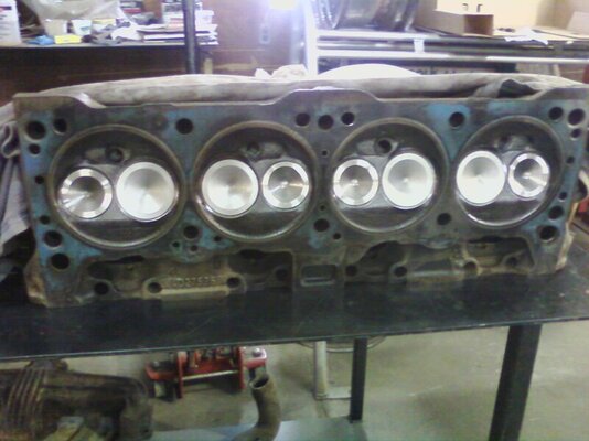

Get the head off, cut the seats, and install new valves If they are questionable.
Good as new.
