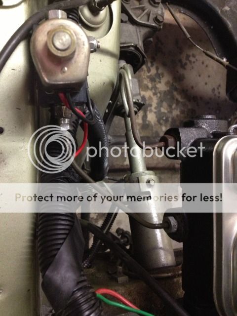

Attempted to make some custom brake lines tonight cause mine are looking a bit shabby. Made this one between my MC and my LL and it was a little short. Not to bad for my first attempt at brake line making. Suppose I will make that line over again and make it longer so it doesn't pull my LL off the fender.
Bending brake lines is so much fun-not! Looks pretty good for a first attempt to me. I'm personally not looking forward to bending any lines when I convert mine to all discs, but I know it's coming. I'll probably just buy one of those Inline Tube kits and modify it as necessary.

Yeah it kinda wasn't as much fun to do as I had thought. It bent in the middle a bit so I'm going to make it a bit longer tonight. The cam and lifters are in Oregon, should see them tomorrow. Can't wait to get them put in and start buttoning the motor up.

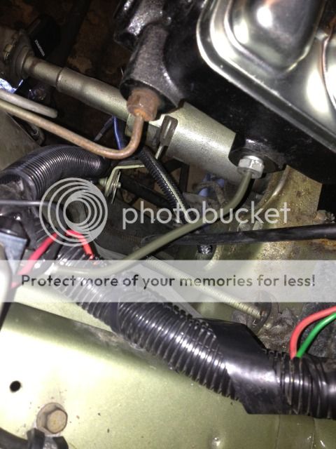

And I got a better brake line made and installed today.
I'm wondering if anybody knows if adding loops too the lines help with flex or not. I have been told it needs a spring like loop in certain areas to help the lines not too snap.
If the line needs to rotate on an axis, yes, loops help dissipate any stresses...same principle is used on titanium hydraulic system lines in aircraft when they fasten to an actuator from a bulkhead. But, non moving lines don't really require it. Just have enough slack bent in to facilitate a smooth easy install, and relieve any type of stress created from fastening to their fittings.
...put more simply, torqueing a line down snug should not in any way shape or form put compression, shear, binding, or torsion stresses on a line as it will weaken at the flare...
Well I decided I wasn't happy with the brake line I made the other night so I made 3 new lines. There not perfect but there functional and fairly clean looking. I should have made my loops all a standard size....but I'm not really wanting to do these again. Progress is happening, finished the brake lines, organized parts and took inventory and even messed around with where to put my tach in. All in all it feels really good not to loose ground and make headway.
Indeed-little things add up quick and better to mess with stuff like brake lines when the engine's out anyway.
