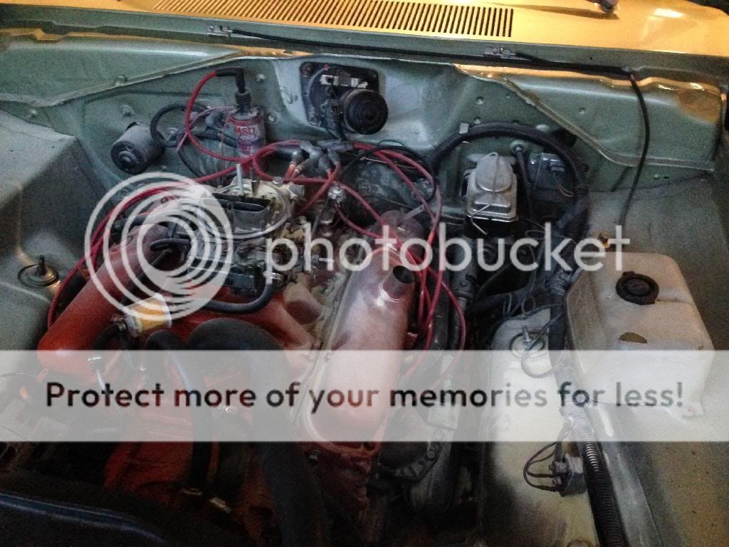

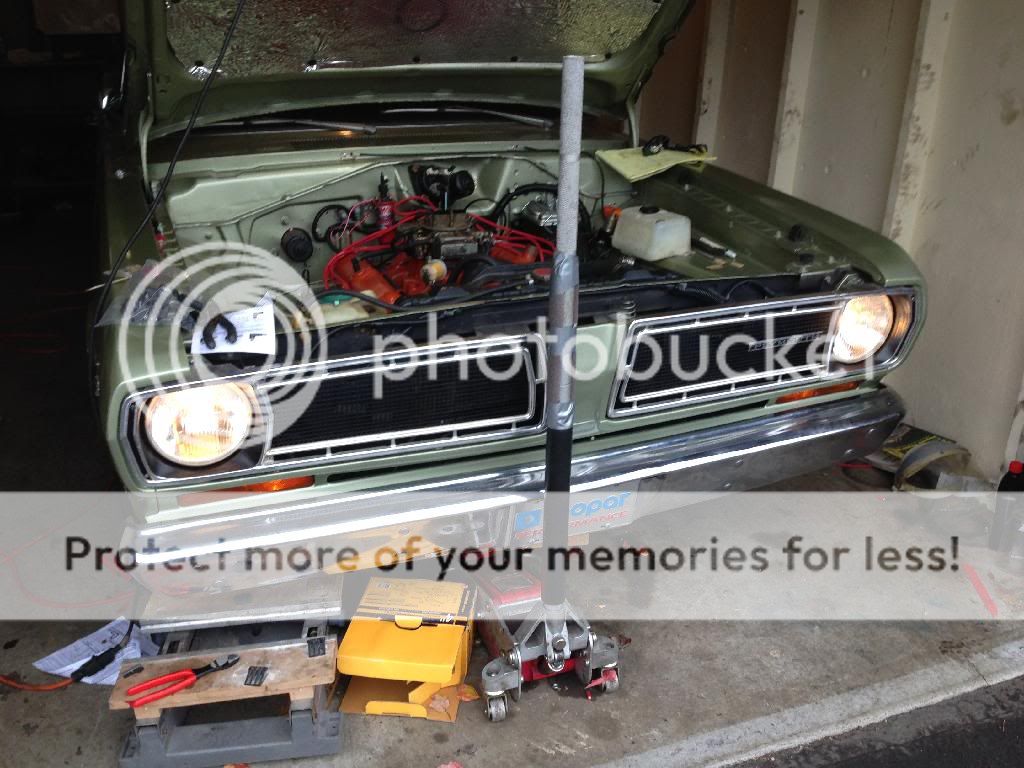

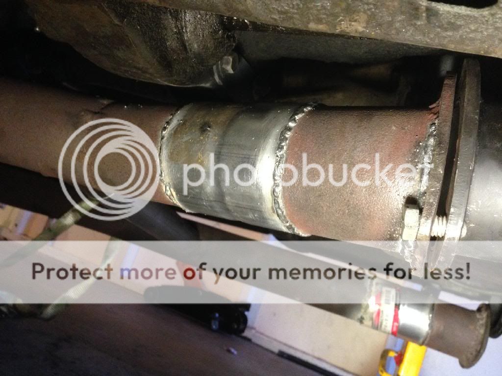

Update time! Been gone for a while, job, family and some other stuff had my attention for a while. Been picking away at stuff on the Valiant here and there, when I get time. Finally got a chance to put the new intake manifold gaskets in and got the intake out pack on. Filled it with fluids and no leakage this time, got the chance to put some fresh cork valve cover gaskets in while it was apart. Also installed my hand me now msd coil. Today I got out and patched the exhaust up, it's a temp fix just to get down the road. While the exhaust isn't pretty it should hold up. Getting new exhaust after the winter season it over. Anyway, just have to get my new plug wires cut and crimped, oil poured in and a final check and its ready to run! Thinking sometime this week right before Christmas I'll be rolling down the road. Here are some quick pics enjoy:)

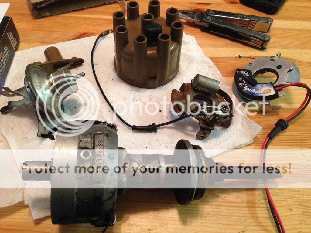

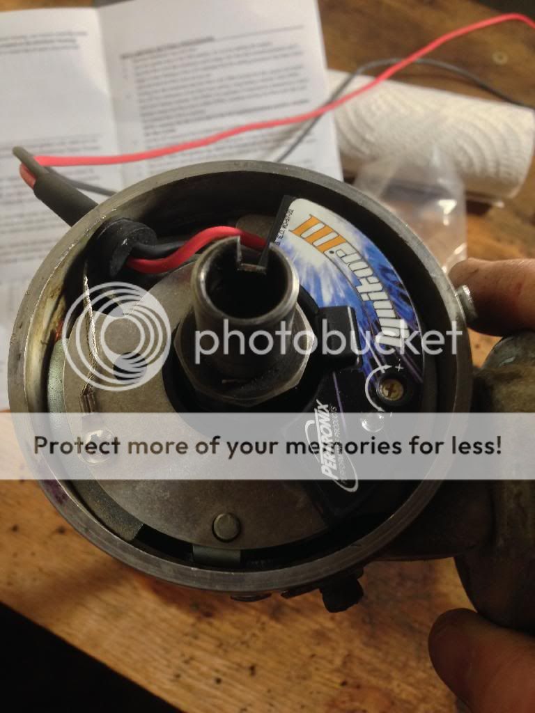

Got a few more odds and ends wrapped up in the midst of the Christmas chaos. Got all the stuff to crimp the Pertronix wires I picked up, took an hour or so to cut and crimp them to length. They look like spaghetti now, I lost the pack of wire seperators I bought so there just loose and hanging now. And speaking if Pertronix I spoiled myself and got there Ignitor 3 ignition system, nice not thinking about adjusting points and having rev limiter. The last thing I managed to get done was actually hooking the battery up and checking all the electrical stuff. Everything but the right tail light worked. Looks like I'm going to fire it up tomorrow afternoon, I'll post a video if everything turns out right.

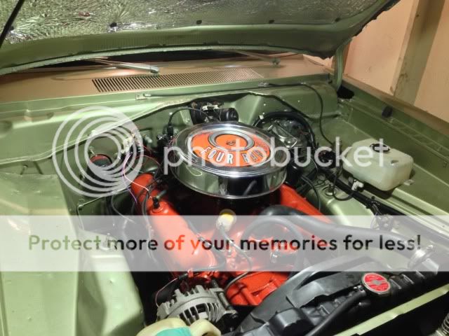

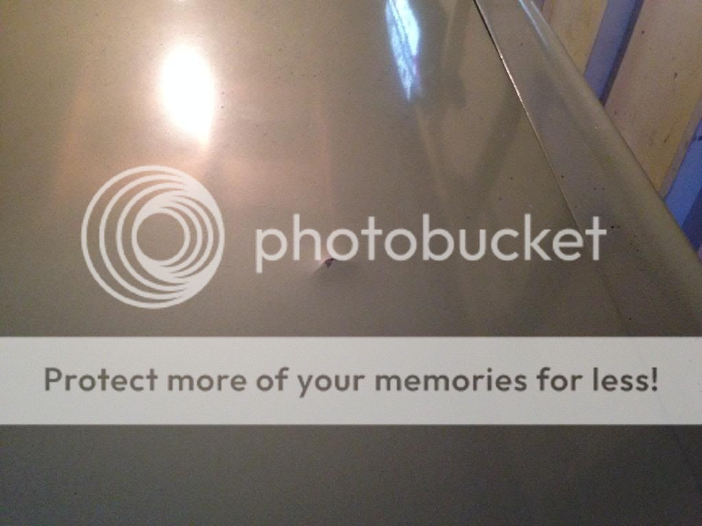

Sad, frustrated and want to cry right now. Tried starting the valiant today, and it did not go well. Somehow it caught fire and had to be put out with an extinguisher. While nothing looks that bad my hood took the brunt of the damage, looks as if the valve cover breather blew off and hit the under side of the hood and now the hood is probally trash. Really want to throw the towel on this car. Here's some pictures.
Wow-I just now saw this! Sorry man, I was really looking forward to seeing something more gratifying than an underhood fire. Did you figure out yet what happened?
Don't give up man-I've been there before...fires scare the **** out of you, and that's definitely a weird one with the breather...
Not how I wanted it too go either. It looks like gas loaded up and it caught at just the right second and all the pressure caused the breather to blow off. Hagerty is coming out next week to look at it, got coverage for stuff like that, might as well use it. Anyway as soon as I get word from them on what there planning to do I'm going get it started. Till then I'm just waiting and wishing I could be driving it.
keep your mind in place. **** happens (all the time).
I think that you easily fix the hood. What really concerns me is the reason of the "backfire".
