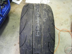

Got some tires on the new rims. M/T 275/50/15

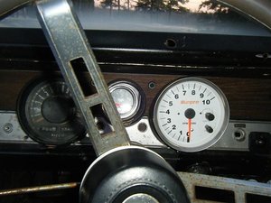

Got a little more work done lately. got the tach I wanted installed

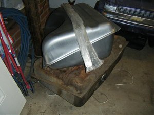

I pulled the old rusty gas tank to replace with a new one. The old one has stopped up three fuel filters. I also got a new sending unit and tank strap to go with it.

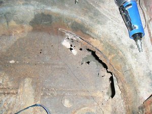

I also started cutting out the rust in the trunk, but the boy didn't like the noise, so I had to stop. I think I'm going to hit it with the plama cutter anyway. Grinding is taking too long

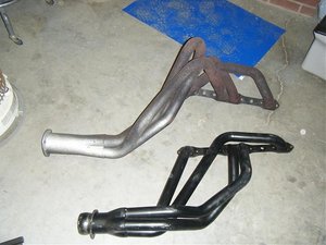

But... since I can't install the tank until I get the trunk repaired, I pulled the passenger side header to install some under chasis B body's. Well see if they fit the 440.

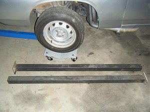

I also picked up these scrap pieces from work, going to try to make some frame connectors out of 'em.
This should be enough to keep me busy for a little while.
I had to work 24hrs yesterday, so I didn't get as much done as I wanted today. I did get some of the rust cut out of the trunk though.8)

Well, after taking the boy to school today I fought with the passenger side header. It wasn't as bad as I thought. B-Body header on the passenger side. I'd say 25% of the battle is won, I know the driver side is going to be a pain:angry7:

Well, the B body headers aren't going to fit without cutting and welding. Its just too tight. I've removed the master cylinder, starter, torsion bar and steering knuckle and it just wont go.:angry7:
Man, that sucks when they don't fit.
Even the one's that are supposed to be a bolt in done deal, never fit for crap.
Fenderwell headers are horrid! (hope you don't like your front tires too much) Problem with mounting regular headers, there is little to no room!! Unless you can find or build a set of custom headers, good luck. Hell even headers on a SB don't fit that well.
The passenger side headers usually go in pretty decent but the drivers side, You'll run into the same issues as your Big block. Big blocks don't fit well at all in those little A bodies. Another thing, big block A bodies don't handle well in turns but for all out straight runs,.... <evil grin>

I'm sick of the headers for now, so I got the first coat of paint on the gas tank. My progress doesn't look like much compared to some of the other awsome restorations going on, but I'm happy with it.:cheers:
today i put everything back as if I never touched it. I had to put the torison bar back in, starter on, transmission lines, shifter cable and master cylinder. All that just to find out that the headers didn't fit
Looking great. Too bad about the headers.
