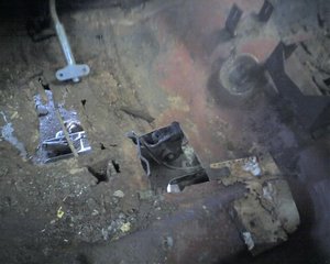

I dropped the tank and cut out the trunk. I think I have enough to use on my car. This thing is real rusty.

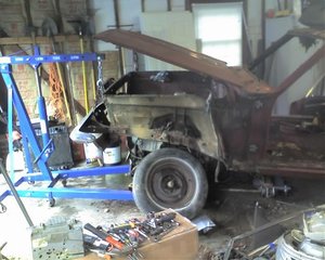

I took your advice and took everythin else off the car. Not bad for 2 1/2 days of work.

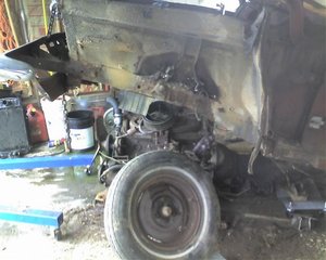

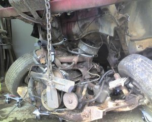

I droped the engine and tranny with it attached to the K member. I had to cut the upper control arms, they just wouldn't come out

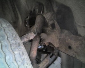

The T bars also wouldn't move, or cut, so I cut out the support from the top
It looks kinda pittiful, doesn't it?

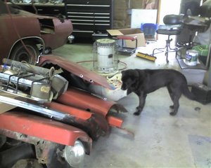

My help for the day
Its much easier when you don't care about the car

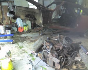

Out and rolled away from the car

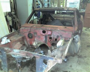

completely stipped. bumpers and all

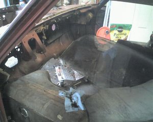

tunnel cut so I have the console brackets

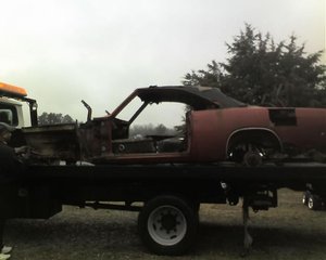

goodbye Barracuda
