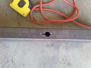

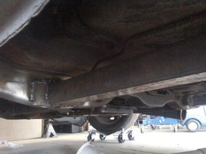

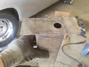

I got the other frame connector done today. I couldn't get the parking brake cable loose, so I modified the frame connector. Once again, I hate my flux core welder.
This hole is for the parking brake cable where it comes through the sub frame
This hole is for the cable to come back through, it doesn't bind at all
Kind of hard to see, but this is the parking brake cable coming through the connector
