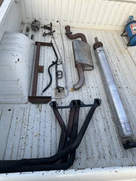

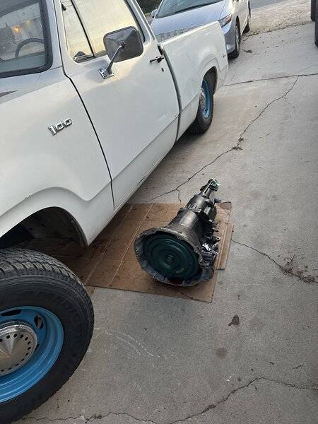

I couldn’t stop worrying about it, and wondering WTF is going on with this damn transmission. Knowing it would keep me from getting a good night of sleep, I took off from work early and said screw it the trans is coming out tonight and going to the trans shop tomorrow. So once again the bed of the truck is full of parts, my garage floor and driveway look like a murder scene from a horror movie, and the damn trans is out. Moving on.

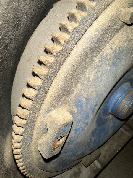

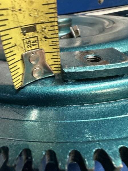

Upon closer inspection this entire debacle could possibly be my own damn fault. Or maybe the fault of the guy building the converters, we’ll see. Looking at the converter, the pads for bolting to the flexplate are very shallow. Like 3/16”. The bolts I’m using are 1/2”. The thickness of the flexplate is like 1/16”. All of the bolts punched through the converter and hit the clutch. I think the pads are wrong. When bolting it up in the truck, the converter has to pull forward like 3/4” . The 904 converter I have here has HUGE pads compared to this one. If anyone knows the dimensions of the bolt pads on a 46re converter please chime in. I’ll know more tomorrow hopefully.
Last pic is a 904 converter.

The converter leaked when I unbolted the flexplate bolts. It was an “ah ha” as well as a “WTF” moment. The 2nd picture above is looking into the bolt hole. You can see the converter clutch inside. The bolts punched through for sure. All 4 of em.
Ah, got it! and see it now. Damn Oops.

The last thing that engages when installing the converter is the pump lugs, I think. Maybe if the pads are too thin the converter pulled out too much and disengaged the pump lugs. That would explain the loss of forward and reverse at the same time, if the filter was not just plugged with debris. Hard to say without measuring. Ask your converter guy how much "pull out" there should be for connecting to the flex plate. There is a spec But I do not know it. I have another 46RH still bolted to an engine but cannot access it for a while to check that.
I just checked a 46RH I have here. The bolts are about .420" long from under the head. The pads on the converter are about .280" thick as measured from the body of the converter. The depth of the holes is actually about .410" when I plunge the caliper into the hole until bottoms out.
I will try to double check these numbers later after I move stuff around for better access because the thickness and depth don't seam to play well together.
Excellent information thank you. I did ask my trans builder how much pull out there should be when bolting the converter to the flexplate and he said it should be around 1/8”. I swear this one moved 3/4” or maybe a little less. The bolts wouldn’t grab the pads and pull it forward. I had to move it by hand. I’m feeling like the short pads are the cause of this whole thing. And me using 1/2” (under the washer) bolts just made everything worse.
