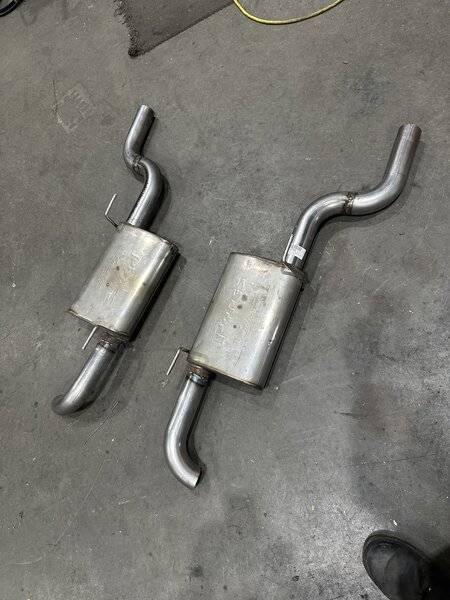

It sounds more rowdy than it is because of the exhaust. I scrambled to piece it together just to get to @Turbo440Dart wedding and haven’t replaced it yet. It’s only about 4 feet of 2-1/2” tubing and some Pypes Violators mufflers dumped out the sides under the frame.
