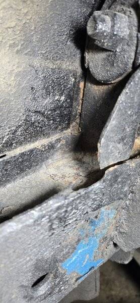

need a fix for controll arm aligment tabs
jazak5
Aug 6, 2015
1,708
971
NY
do they make replacement upper controll arm (EARS?alingment tabs)??
I don't believe anyone does, at least not for an A-body. A picture of the issue with yours would be helpful, depending on what's going on you may have some other options
I used those years ago, nice pieces, at least at that time.
Well it looks like uupper arm bushings also. Drivers side front. The rear looks ok

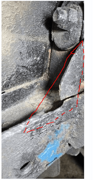

Make a plate and weld it in behind
or clean it up and make a filler plate and butt weld it on
Going to the autorust website, it says all A-body products were discontinued in 2018 and to go to Classic for any sales. So, just FYI, I would 100% call Classic to confirm they're actually in stock before ordering. Because Classic has totally "sold" parts they don't have that have been discontinued before.
That actually doesn't look bad at all, I would just weld the tab back to the frame rail.

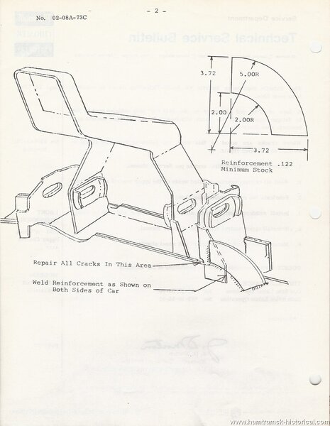

This was actually a TSB from Mopar back in the day, they advised welding a gusset in there on cars that had the issue. You can see the full size versions at hamtramck-historical, but here's the preview

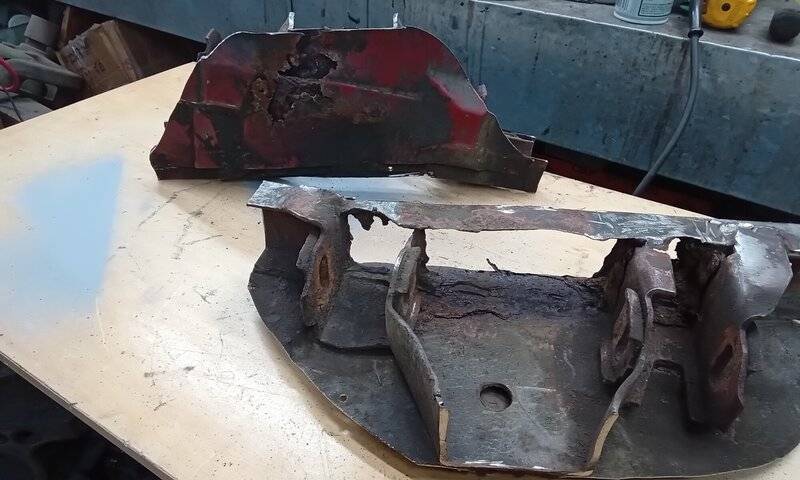

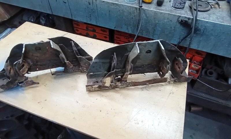

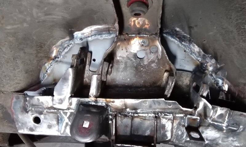

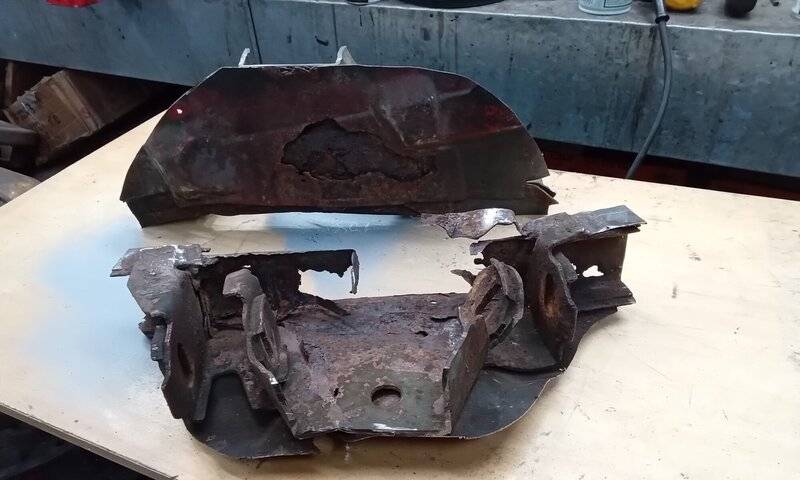

Check the condition of the actual frame rail.

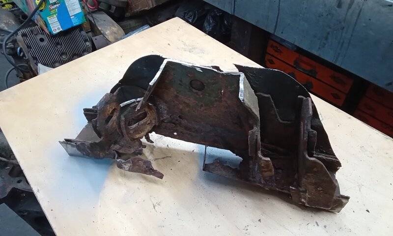

I just got thru replacing the upper frame rail/control arm tabs in a 67 Barracuda that had been condemned.
Wouldn't hold an alignment after owner spent $7k having suspension done, and other stuff.
Upper control arms were moving afict .
Dirt collects and forms mud in the pockets between tabs, top of frame rots

Now that's some nice work! It's make me walk away, but that's some nice work!
Someone here on FABO welded temporary tabs on top the frame rails ahead and behind the OEM tabs and used all thread and nuts to use as a holding jig to keep the alignment correct while reworking the area.
