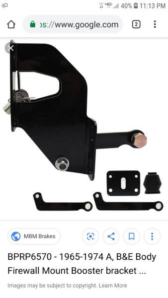

Need a fix for this:

Looks that way. I'm sure you will have issues to overcome like push rod length but in the end I think this will work. Perhaps someone on here has a stock 65 or 66 A body power brake bracket you can look at pictures of and get measurements from . Basically it is just moving the push lever up on a higher plane and the master should bolt to the bracket just like the booster does
oh, was that only used on 1965-66 cars? i thought it was on all the power brake cars..that would have made it easy to find if it was on all of them..
It was used on all sorts of cars not just A bodies. You need to really look into it before you spend any money though. I have no real knowledge as to weather this will actually work for you. It seems like it will but you need to look into it deeper .
I had a really easy fix that I did on my 440 72 Swinger years ago. I dont have pics anymore. But, I had factory disc brakes, I pulled the master cylinder off, ditched the power brake booster and bolted the master cylinder back on. Worked great! I could even pull the drivers valve cover off without taking off the master.
are you saying you bolted the MC straight to the firewall like mine is in the first post?
No, my car originally had power brakes. I removed the booster and bolted the master cylinder right where the booster was. Utilized all the original brackets and lever.
