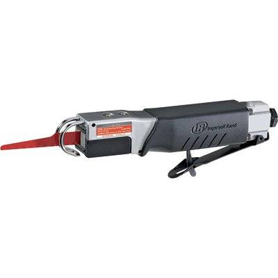

Use a small air saw, put the blade in the hole and cut the piece your trying to get out in two or three pieces. Pie cut it front the inside out. Cut until you just start hitting the threads. You should be able to work the pieces out with small chissels, picks. After it’s out, clean up threads, and use red loctite on the bolt when you reassemble
