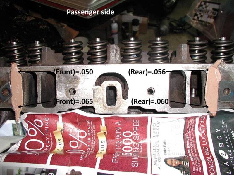

Got my open chamber heads (3418915B's) back from the machine shop. They removed 0.012 from the deck side to reduce the chamber size to adjust compression. They did not take any material off the intake side of the head. I've performed a trial fit of the intake manifold / heads on the motor with the head gaskets in place. I fabricated some washers the approximate thickness of the Felpro intake gasket (0.055 / 0.060) to place between the head and intake, and used clay between the head / intake to measure theoretical gasket compression. The head bolts were just snugged up.
These photos show the actual thickness of the clay. The measurements show that the desired compression is reversed, i.e., the compression is greater at the top of the port, less on the bottom of the port. The compression also varies front vs rear. I'm using the guidelines in this article, http://www.hughesengines.com/Upload/TechArticles/INTAKE_MANIFOLD_SEALINGJULY2015.pdf, i.e., for example, add the clearances at the top of the port for the front positions, do the same for the bottom of the port, you want 0.006 / 0.008 more clearance at the top of the port for proper sealing.
Using my measurements,
Front position (top of port): 0.050 + 0.050 = 0.100
Front position (bottom of port): 0.053 + 0.065 = 0.118
So there is 0.018 more compression at the top of the port.
The rear positions:
Rear (top of port): 0.051 + 0.056 = 0.107
Rear (bottom of port): 0.055 + 0.060 = 0.115
0.008 more compression at the top of the port.

A .060 thick gasket will probably work but .008-.010 should have been taken from the intake face.
Looking at your numbers a good gasket will seal that up. The gasket is there to take up some variance in machining and fit.
BTW, again looking at your numbers it's not unusual to see twist and roll in a machined surface like that after it has been run. You can indicate the face of the head in the mill and correct it but damn, it just isn't worth it to me. Make a clean cut running the average from end to end and side to side and take .010 off of it and go.

I used the washers to simulate the thickness of the intake gasket and limit the crush of the clay. I plan on using the Felpro gasket that leaves the heat crossover open. The gasket measures 0.055 / 0.060. On the drivers side head, that gasket thickness looks marginal on bottom the ports. Did you read the Hugh's reference article? They use steel washers with their wax material.

Right, so the shims are changing his readings. Who says the shims are flat? Who says they are exactly parallel to each other?
I made the shims from an old Felpro 0.054 head gasket.

why use spacers and clay, makes no sense, oh hughes said to? If u want to see what the actual gap is use just clay. your average top gap is .052", average bottom is .058" - with spacers artificially holding the intake away from the heads
The only things you can really measure with clay is the RELATIVE gaps top-to-bottom with the intake undistorted by the intake bolts. The washers just make the numbers more consistent side to side and easier to interpret and to visualize in the actual installation IMHO.
However the relative gaps top-to-bottom will be the same with the washers or without. You could use washers half the thickness or just clay (no washers at all) and get the same RELATIVE top-to-bottom gap measurements.

As long as the intake bolts are not hitting against the upper edges of the holes in the intake as torque increases (and thus limiting the intake's movement downward), then the crush for a given bolt torque does not change with the heads cut or not. But IMHO it is wiser to do as above and start the intake 'riding high' a bit as you try to start the bolts.
It would have been best if these measurements had been taken before the milling as well.
You don't know if the machine-shop created this skewed plane, or if it was there in the casting from factory.
It's also difficult to tell if the heads have been milled before.
Having worked with a Van Norman head-surfacer a couple of times for instance, I know it can be a hassle sometimes to properly clamp down heads that only have angled surfaces on the sides.
It's easy to mill at a veryslight angle if you're not careful mounting the head.
