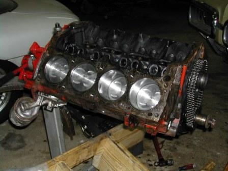

What year is the 318? If a simple rebuild is in the works, specify a 67-70 piston. This is the tallest of the 318 pistons meaning higher compression with no machine work. My Demon has a 68 318 and 302 heads. We've measured the CR @ 9.3:1 with nothing more than a little clean-up on the block surface and heads.

The 318 is a 68, I was thinking domed Pistons, but the I don't need to replace them I'll probably just mill the head down.
IIRC 67-69 and 80's LA rollers (which have the 302 head) are advertised as 9.2:1.
That's about perfect for pump gas 87 even.
No need to change pistons unless they're junk.

The later 318 pistons were flat tops. The earlier factory pistons had 4 valve reliefs.
