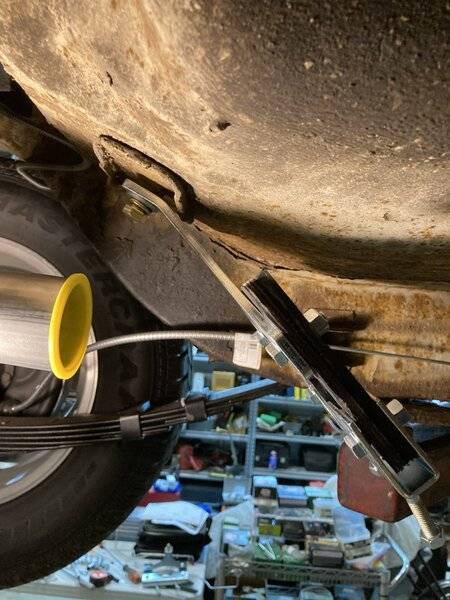

Need a little help. Not sure what is going on but my new TTI exhaust will not fit. Bought the 67-76 A body 2.5” full exhaust with H pipe. This is coupling to their small block shorty headers and extension pipes. My first issue is the intermediate H pipes run into the floor.... not good... and then the second issue is the muffler hanger clamp that bolts to the seat belt bolt is the wrong angle and not far enough back. If I place it on the pipe and hold it up it would be perfect if there was a hole on the floor on the move vertical wall of the floor...

I have read posts from others regarding the hangers, it seems that they are E body ones, and the fix is to bend the tabs in a bench vise. I can't help with the head pipe issue, I never used the shorty headers. Maybe someone else can help you with that.

Im going to remake the midpipes.... including adding flanges to the header extension pipe connection. And try to locate holes to drill on the floor pan to use the muffler hangers
My TTIs did NOT bolt to the seat-belt plates.
There was a proper hanger already on the one side, and I bought a matching hanger for the other side, from Year-one I think. As you said; further back and higher.

You are bolting the exhaust system to the seat belt anchor plate. Need to get the proper mount from year one that mirrors the right side of the car.

Sounds like maybe the H pipe is upside down?
If the H pipe is hitting the floor, that would be my first guess. OP needs to flip it and try that way.
Also - agree with having to shorten the H pipe for 108 inch A bodies - i.e. 67-69 Barracudas, Dusters, Demons and Dart Sports and 67-76 Valiants except Dart-based Scamps. Darts had a 111 inch wheelbase (except for Duster-based Demons and Dart Sports - clear as mud, right?).
Also - absolutely agree with those who suggest that the seat belt bolt is not where you hook the muffler hanger. I put TTI step headers and a 2.5 inch X-pipe exhaust in my 67 Barracuda and once I shortened (cut) the X pipe at the muffler end it all fit perfectly. But I already had installed a reproduction of the factory style passenger side muffler hanger bracket (car has had dual exhaust since 1991). As I recall, even though this was originally a six cylinder car, there were indentations stamped into the passenger side floor for locating the bolts for the passenger side hanger bracket. Just drill the holes, bolt up the bracket and go.
