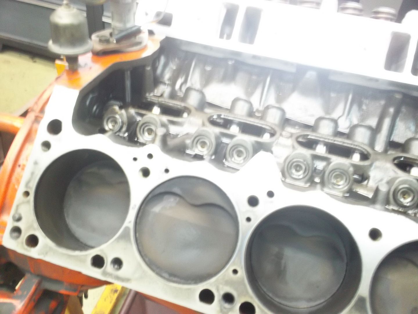

From the pics you posted its hard to believe you only have 3000 miles on it. My feeling is your carb was way rich and rings never seated properly. Pics look like you been sucking oil past the rings. Did your oil look really dirty and diluted?
It was abit rich I am pretty sure. And if the rings never seated wouldn't I be burning oil? and it doesn't burn any oil at all, alot of coolant spilt into the cylinders when I took the head off. The spark plugs also looked pretty clean. And the oil was fine, and not diluted or anything.
Pistons look okay for 3000 miles , some strange patterns on them , but that might be from the bad gas you had . You would have known if the rings did not seat with all the driving you did .
Here is a pic of my pistons after around 10,000 miles , yours are a lot cleaner(except for the coolant ) . Hope there is nothing wrong with the heads , good luck.

After the bad gas I intentianally left the plugs in to see if they would clear up, when I pulled them for the compression test the plugs did in fact get clean, I would guess that the Pistons were slowly getting clean again. After the bad gas I stepped on it once and it left a black cloud behind me, only did it thag time, never had any more smoke after that. After the bad gas I only put about 50 miles on it so it never had a nice long drive to clean crap out.
The coolant went everywhere too, it filled up the cylinders completely, that's why they look wet, same with the heads, it was sitting there for quite some time and the level stayed the same as well.
