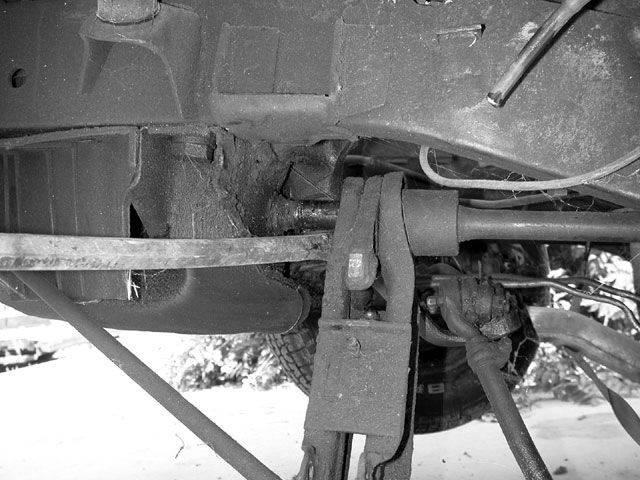

Got one of these in the garage?
Torsion bar is still in til I get a removal tool so I don’t jack it up. It was in when disassembled it the first time and came out with the arm with a couple of taps of the hammer on the arm. I’ve got a small maps torch.
