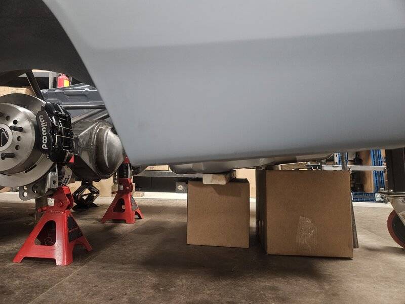

more mock up.....working my way to the back. Went with a Strange 9" w/ 3.25 gear. Originally planned for a Strange S-60 but the lowest gear available was a 3:55
this combo will put Butch at 1820 rpm at 70mph with the .75 overdrive engaged............@ 5200 rpm he will hit 200 mph. SHAZAM!!!!!
rear 31.5 tall tires have a sectional width of 15-1/2" .....should be good with 1-1/2 plus on each side of the tires.

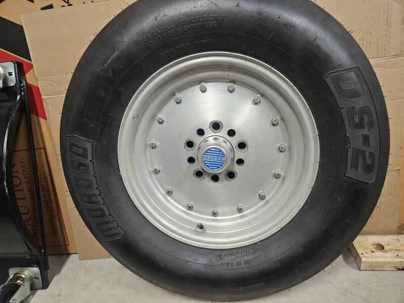

fake Super Tricks almost done mounted up on the street tires we are running. Just need a Strange decal for the axle (cap)
last pic is a real Super Trick / Moroso DS-2 drag tire for comparison.

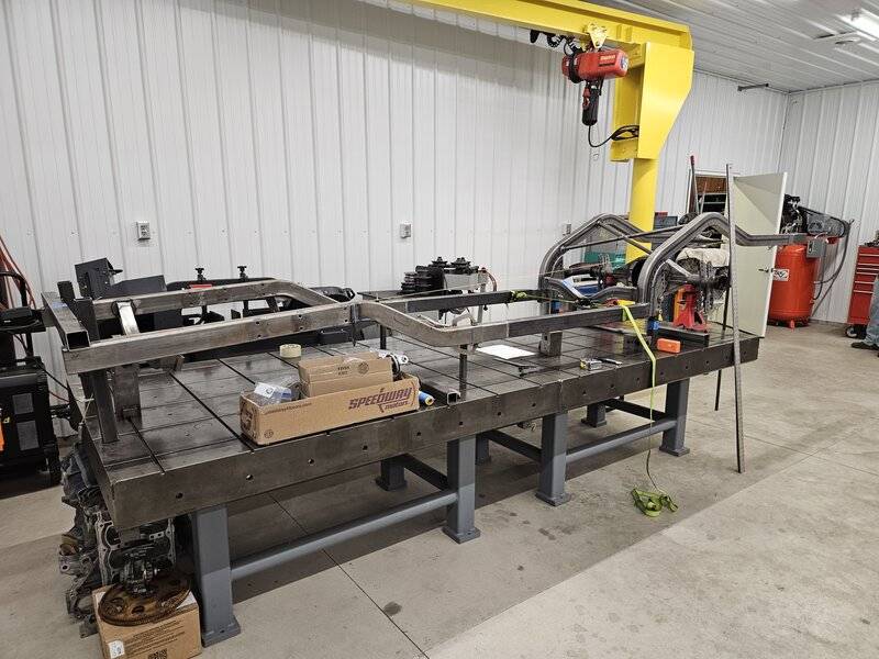

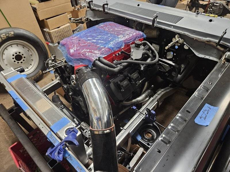

Mating the front with the rear. With sub assemblies already test fitted, next up while on the table are the isolated shock mounts and panard bar, then fuel tank install.
Have I ever said I like making stuff?.
Wow, that's quite a nice shop
That is Fogs addition to his original shop he built a couple of years ago. He and I have a joint venture under construction right next door, The front 2/3 will be the new HDK world headquarters while he will retain the rear 1/3.
