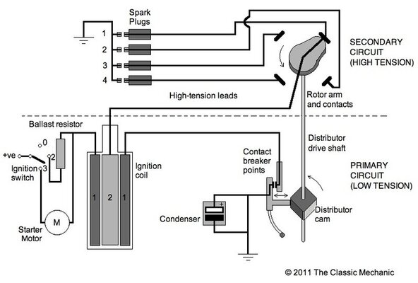

The ignition switch provides two sources of power to start the engine.
While cranking the coil gets its power from IGN 2 after the engine starts it gets its power from IGN 1.
If the ignition switch is not functioning correctly it will crank but not provide power to the coil.
To test this disconnect the yellow wire from the starter relay (That way the engine will not crank).
Check for voltage at the coil positive with the key in off it should read 0v, turn the key to run and it should read 6-10v, turn the key to start it should read 12v ( or whatever battery voltage is)

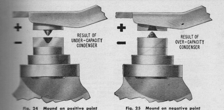

Keep in the back of your head that "new does not mean good." In other words the condenser/ capacitor can be be defective, even tho new, as can other parts
^^Unfortunately that is far from correct. I've gotten into many arguments about this, but if the cap/ condenser is bad or missing, the car will normally not start. So while, yes, it does keep the points from burning, it has to be in good working condition just to allow the vehicle to run. Ever look at an ignition scope pattern? The little sqiggles? That is "ringing" a term which is also applied to LC circuits (Inductor/ capacitor) circuits in RF circuits. Just like the coil magnetically charges, and then discharges, the cap ALSO charges due to the flow of current from the coil primary. These two trade energy back and forth, until "circuit losses" cause the ringing to dampen out.
In any circuit with L and C, "ringing" is THE definition of resonance, just like a bottle you blow across like a flute. If you change the value of L or C, AKA either inductance or capacitance larger, the resonant frequency is lowered. Less value of either raises resonant frequency.
Probably MUCH more important, is, in defiance of "internet wisdom," YOU CAN NOT check a capacitor with a multimeter!!!! This is because one huge problem with caps is LEAKAGE current. You MUST test caps for leakage and determine that leakage is low or unmeasurable, BEFORE you evaluate capacitance value. This is because a leaky cap, even one that is good enough that it still works -- perhaps poorly-- the leakage will cause a capacitance test to read flalsely HIGH. This means the actual capacity could have deteriorated, but the value test might read fine.
So how do you? Do what? test? Proabably cheapest and most reliable is to just replace the cap. That worked pretty well until chineseoization came along.

This is a good point to start. Correct ways to diagnose ignition issues is forward from the beginning or backwards from the end. A lot of us go backwards because it's easy.
I'm sorry but if you do not do a high voltage leakage check you are spinning your wheels. I have found FAR more bad caps that were actually leaky rather than low or high in value, substantially.
The old outboards I mess with, I bet more than 75% of the caps get garbaged. I actually don't use new OEM style caps. I gut the cases, and stick a plastic cap in there, and "Goop" it into place.
I agree, Most people do not have that type of test set more to check if it is shorted.
I'm guessing at a faulty ignition switch and/or corroded/faulty connections at the firewall junction block.

And no, @halifaxhops , @67Dart273 is right about the condenser; without it the engine will be difficult or impossible to keep running, if it starts at all. If no condenser, then no sharp drop from high to low (voltage to no voltage) in the coil primary winding, therefore crummy/no induction in the coil secondary winding, therefore crummy/no spark. Your info on how to check for an over- or under-capacity condenser is valid as far as it goes, but not really relevant at the moment.
