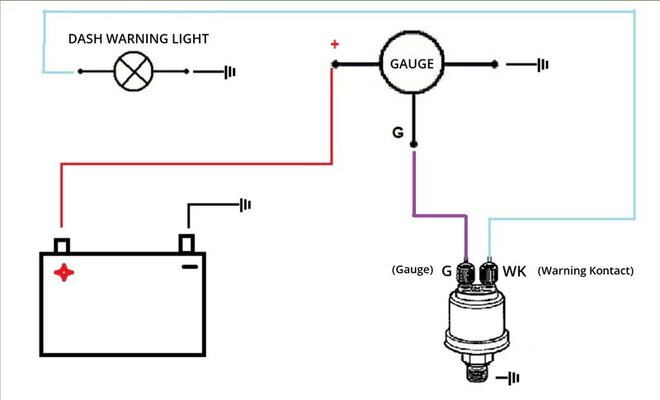

Seemingly, twin-terminals sender units can operate at the same time the warning light and a pressure gauge.
Here's a schema I found on internet today :
G/WK twin terminals sensor unit

Hi Cudamark,
If I understand well, the light sender threads are NOT 1/8npt and an adaptor is needed?
