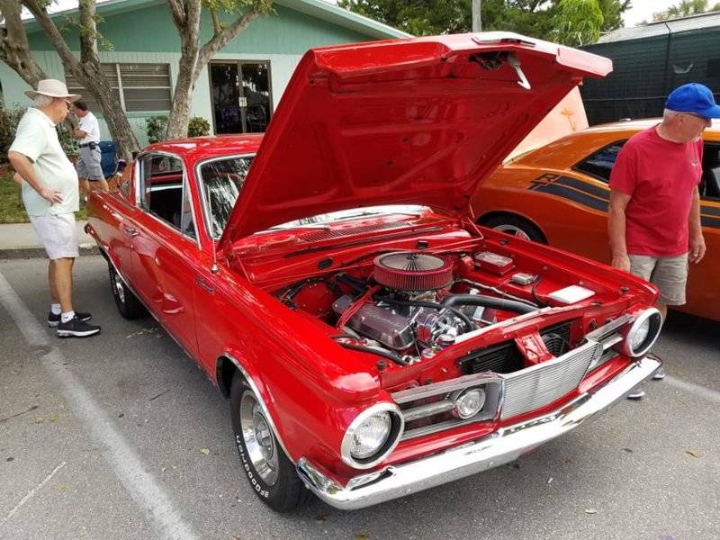

Engine specifics were in earlier post but it is a 360 I rebuilt years ago it’s always been just a cruise in car so it doesn’t have that many miles. It has a whiplash Cam flat tappet MSD pro billet distributor at the moment with six AL box and matching coil has been running really good until this distributor got jammed. I was on the first day of the power tour I had ran almost 800 miles that day to get to the starting point I had just put in an a500 before I left that was really making the highway travel great

I dig that car---

I really hate that your having that much trouble with it, that is a really nice looking car, and hoping for an easy solution. I am curious as to what it is, I can't imagine what would be damaged with compression readings that good. I imagine it's a healthy combination when it's doing what its supposed to.
