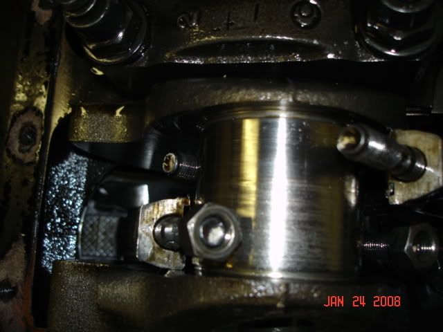

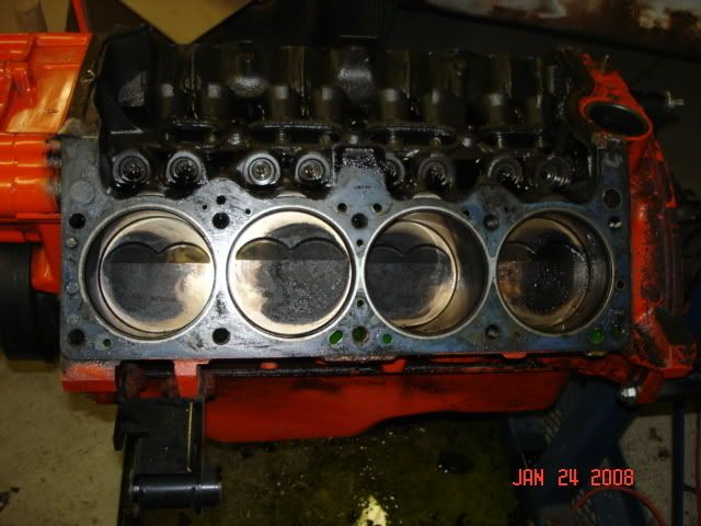

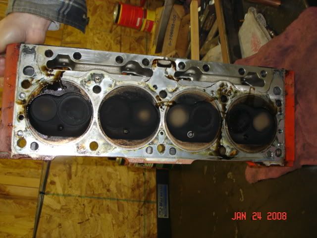

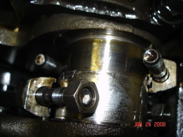

well it spun #1 bearing.. #2 looks prety bad too. just have to figure out what i want to do now.... i should have a set of rods in the shed so i can replace these two and i may have a crank out there too. if not i have a couple 360 motors that i should be able to rob one from. not sure if this crank is able to be cut... still have to pull the rest apoart and see if there is any more damage.

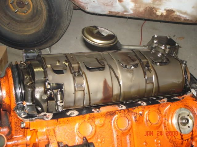

your oil pick up screen looks very clean and you had good oil pressure.
Lets take a look at your crank bearings.
It sure did eat the bearings up all the sudden, or did you have a clue?

actually the damn thing ran smooth and normal... at 2500rpm you heard the knock but other then that smooth as can be.
i had it at the track months ago.. the car shut off and came back at top end of the track then i ran like one or two more runs came back and shut it off... then it wouldn't start... towed it home and found the coil took a crap.. put a stock one on it took it for a drive and it drove fine until i hit it a bit and it hit 2500 rpm i heard the noise.. haden't run since.. pulled it last week and pulled it apart last night. oil pressure the whole time.

First think I'd check for is if all of the oil passage plugs are where they are supposed to be.

Keep us updated , I would like to see the crank bearings 8)

I agree, but if the plug is missing that goes in between the pressure and return feeds, your oil pressure will show good but you will be feeding unfiltered oil through the crank. Never hurts to check.
Mine looked like that shortly after I got the car on the road. The guy I got it from rebuilt the engine but didn't have the rods resized. Had stock rod bolts in it too. I took it apart and it looked nearly identical to yours. Checked the rods and 5 out of 8 were out of round bad. I had them all resized and ARP bolts put in. Put it back together and haven't had any problems.
BTW: My crank was able to be turned and they did that. When I put it together the 2 cylinders on that journal checked .010 lower in the hole. I asked my machinist about it and he said that happens alot because they offset grind the crank usually with spun bearings because the bearings take more off of one side than the other. I can't say I was pleased to hear that. If it ever happens to me again I'll look for a different crank.

have had the same problems with my moter. have found you need to modify the oil system alot for substaned high rpm. this was my first experience building a big small block an i lost the bottom end due to starvation 3 times before i did alot of reserch. mine would run all day at 4500-5500 but when you turned it up to 7000 she would starve the bearings
were you running a stock oilpan on that thing? If you are, running those kinda rpm's will do that. It'll suck the pan dry, then u get spun bearings
